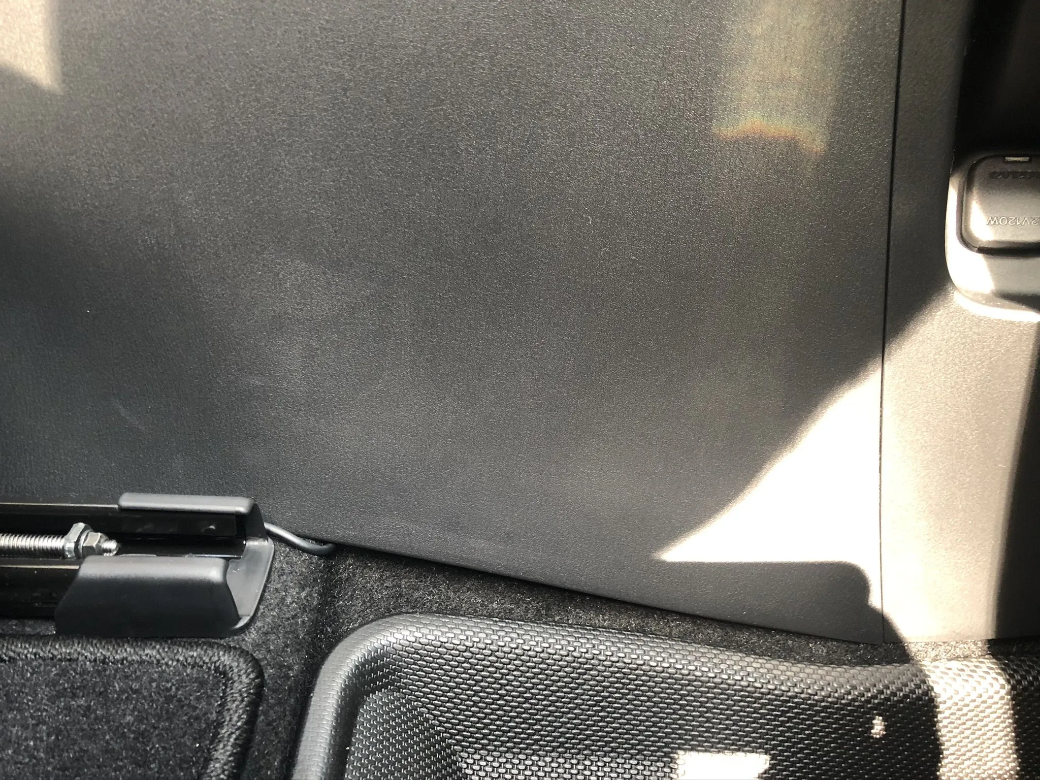

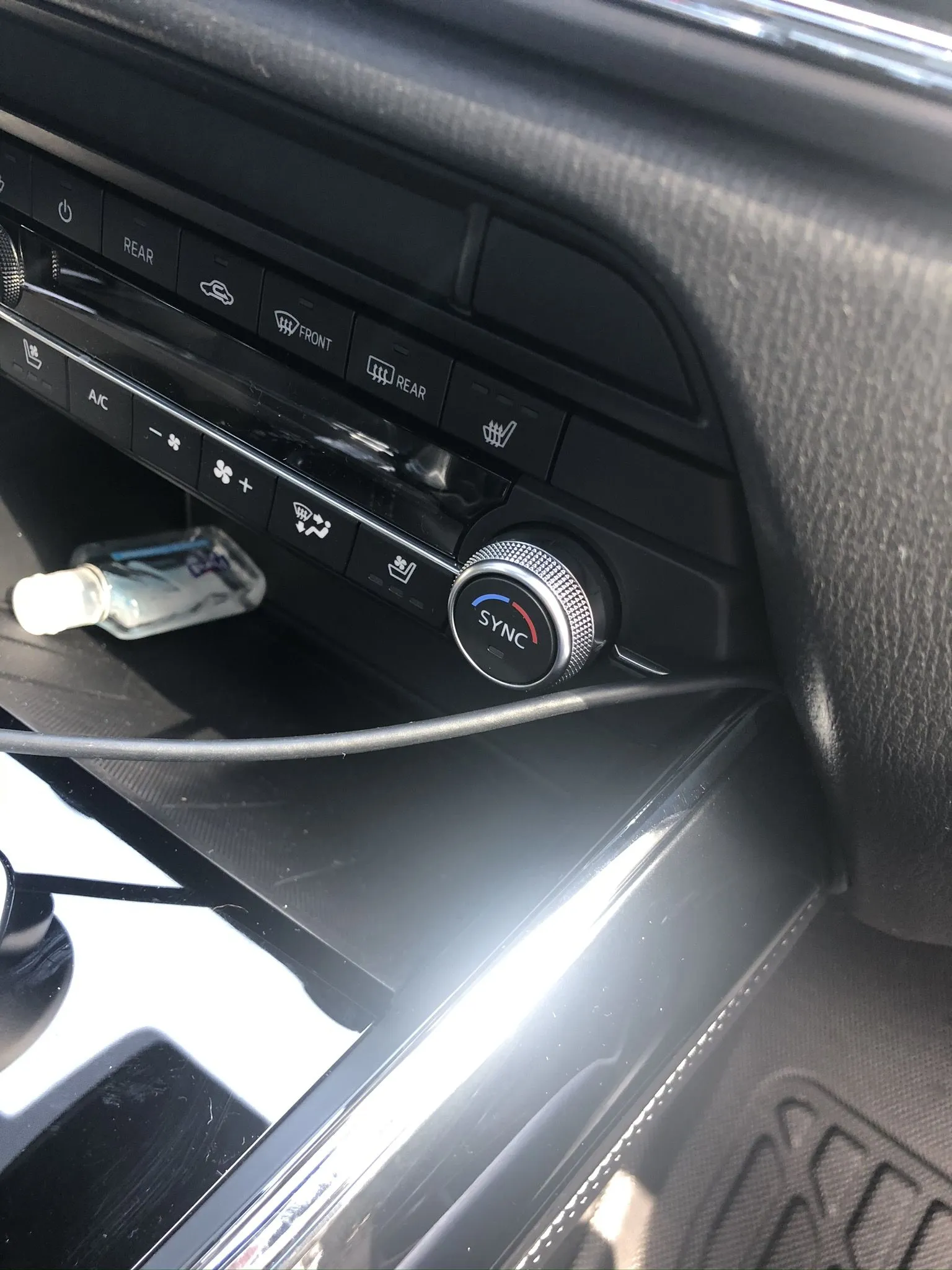

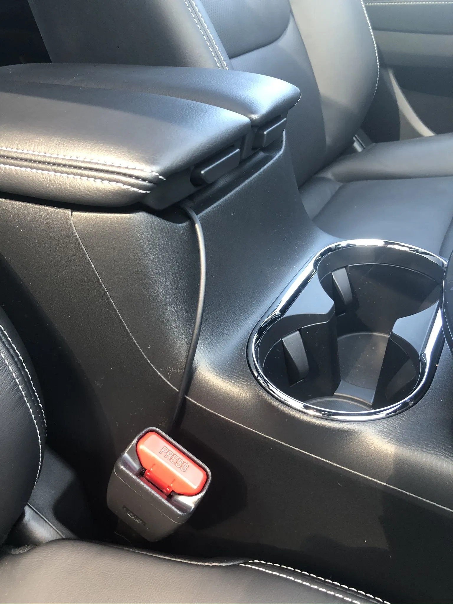

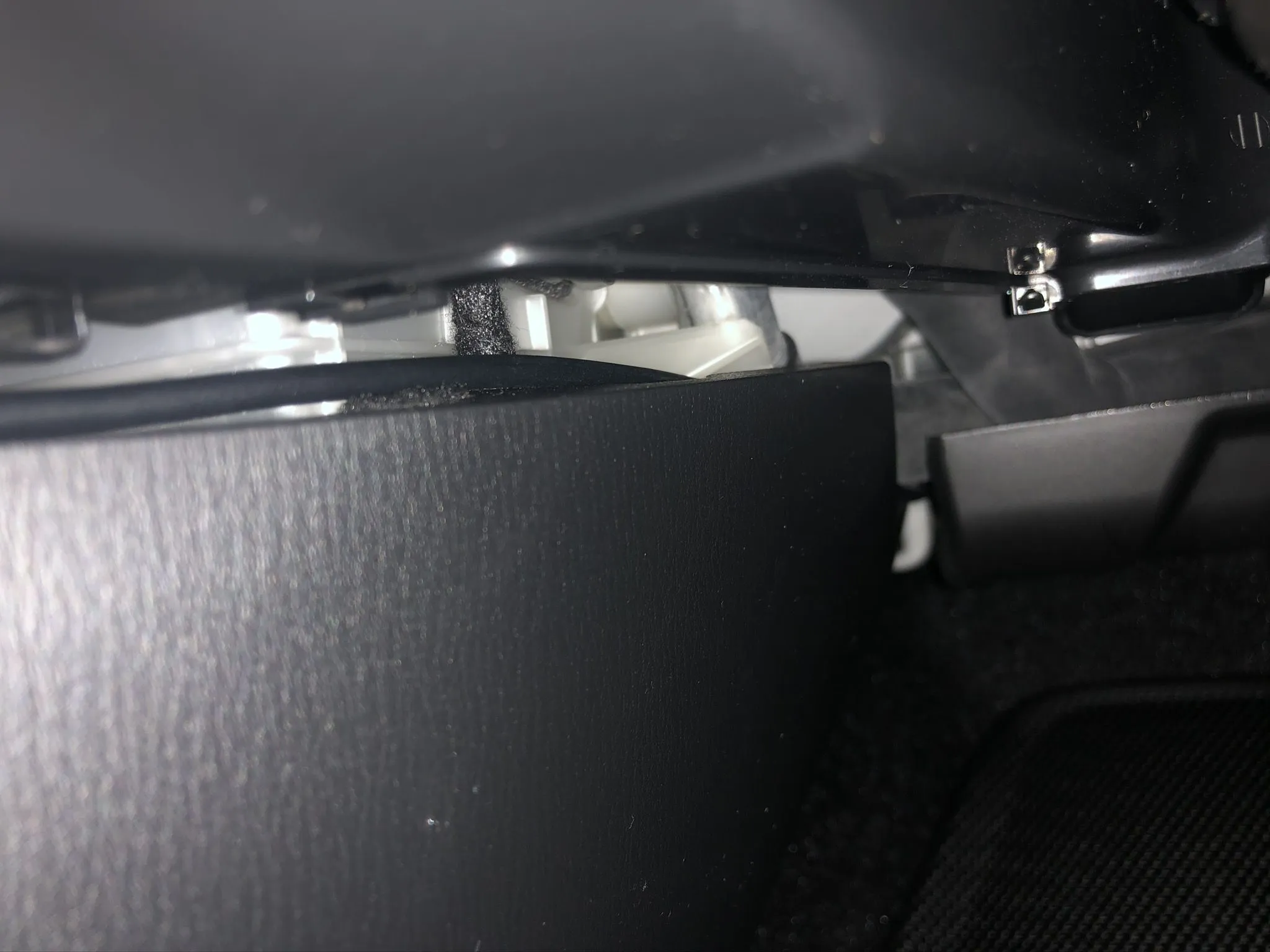

Finally got around to routing a cable from the front console to the USB as per Youri’s suggestion. Would like to make it more permanent but my wife probably won’t appreciate me drilling holes in a 2 month old car 😬
I picked up a 10ft Amazon Basics lightning cable thinking it would be cheap and therefore thin and easy to squeeze into the panel gaps. Turns out the Amazon cable is thick and sturdy. I pushed it in as far as I could before the cable started to deform. In hindsight probably should have got a fabric covered one just in case it rattles along the transmissions tunnel. Had maybe 0.5ft of slack left. Overall pretty happy to have the cable neatly tucked away.

Great ! Simple and effective. Thanks for the photo. Once the car is a bit older you can take out the drill and improve the set-up ;)
