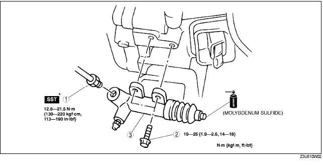

OK I think I'm having this problem you mentioned MrGiggles - air past the threads.
I bought the rebuild kit for the slave, along with the speedbleeder. Everything came apart and went back together reasonably smoothly and I was very excited to try partnerless clutch bleeding. This initially went well - a mushy pedal for a long while and then pressure started to be building up smoothly with very little air. After half a jug of fluid. Then suddenly it felt like something let go and clutch was flat again. I only had the bleed screw just cracked but I tightened it and then cracked it slightly less. Finally had to get a ride to Lordco and bought two more jugs of brake fluid. Tried different combinations of bleed screw, even tried thick grease and went through another jug of fluid and a crap load of air. Now I've packed it in for the night. :(
No fluid leaking out anywhere else - I thought that maybe when I pushed the new piston cup/seal into the slave cylinder that maybe something happened to the seal but I don't see any fluid leaking out anywhere.
Does this mean I'm stuck with using clutch partners? I only have one jug of fluid left so I'm wondering if I should just replace the bleed screw with original and find a clutch partner that can follow instructions better than my last partner.
Thoughts? Anyone had any success with the speedbleeder option? Or was the lack of response to my earlier question because it just doesn't work?

Well I cleaned up the stock screw and waiting for a bleeding partner.
I'm pretty sure if the piston seal inside the slave cylinder were to leak the fluid will fill the boot, and then eventually leak out onto the ground. I checked over the old seal - I suppose there is a slim possibility the lip of the seal could have folded over on itself upon insertion, but I put fluid on it and went slowly. So far no fluid obvious but it is difficult to pull back the boot once installed so I'm a little reluctant to do it unless I have to.
The piston looks different in the slave - the rod that pushes it floats externally inside the rubber boot between the lever in the transaxle and the piston cup with the seal. I was surprised - no corrosion inside the bore, though I cleaned out the bore with scotchbrite and all orofices with brake clean/q-tip. Somehow there was some black stuff when I was purging the clutch fluid. I'm surprised because the system was pretty much purged (brake side and clutch side) when I did the master cylinder a few weeks ago. Both flex hoses are reasonably new - the one to the reservoir is 3 months, the lower line is about 7 months old. The lower one blew on me, leaving me stranded.
Anyway. Fingers crossed bleeding will solve my issues. Wish I had some thread sealant but my friend will be here any minute.
OK! Mission successful - simply had to bleed the system the old fashioned way.
