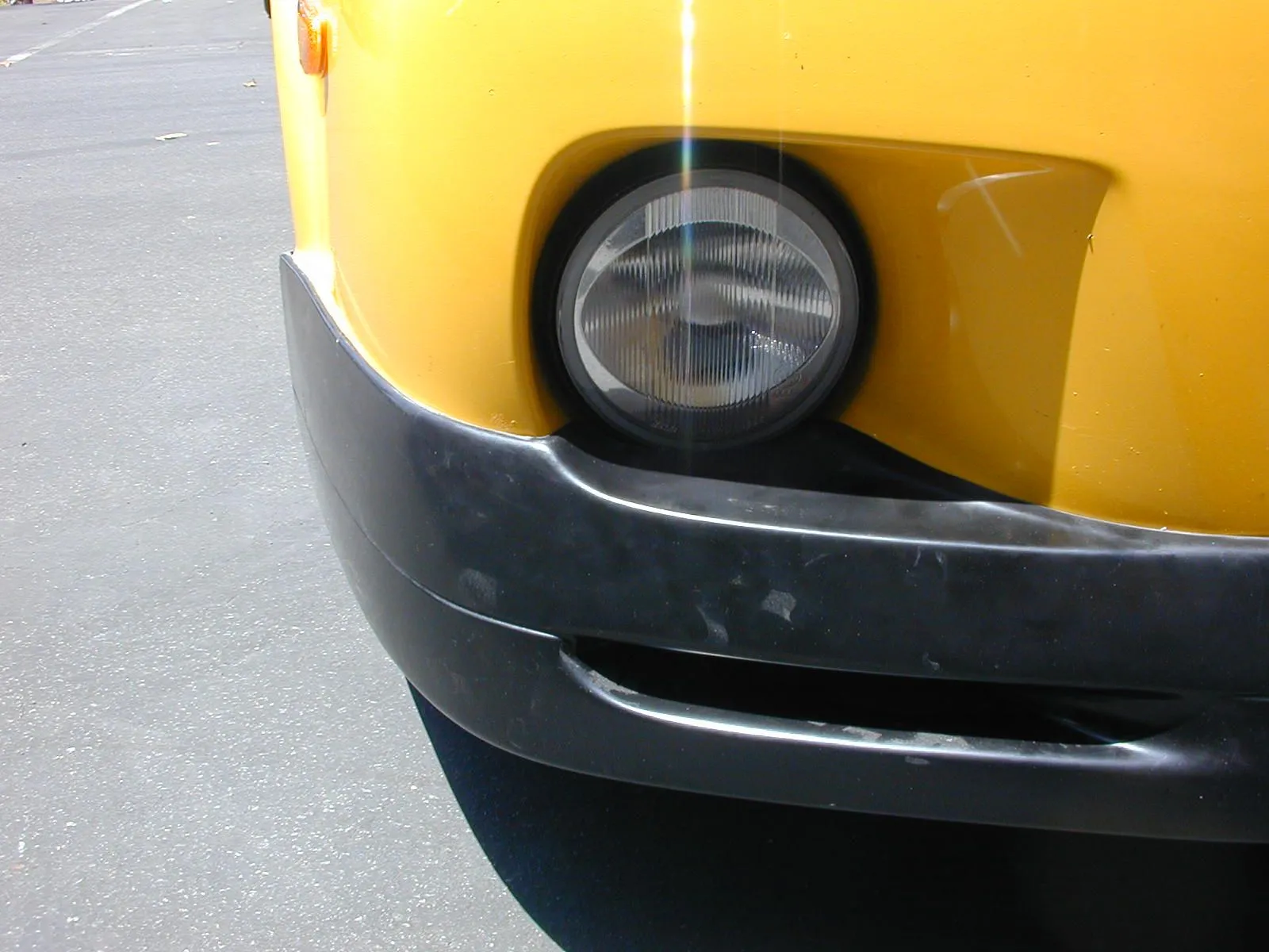

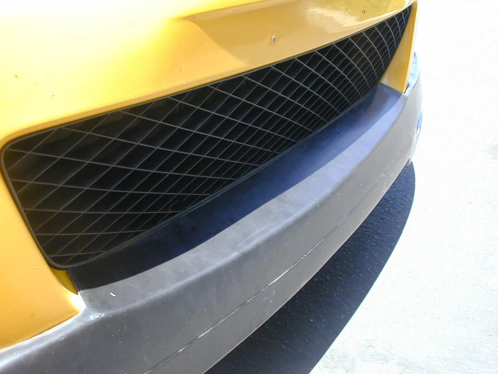

what I want to know is this. When I look at pics of people's rides with the lip, some times it hangs down like in example 1, and sometimes it if perfectly in line with the side skirt like in example 2.
ex 1:
attachment.php
ex 2:
I'm not sure if it's just because of how it's fixed behing the wheel well, or if it's something else. I'm getting it put on soon, and I wanna know the best way to get the ex 2 fitment. Thanks for letting me use your pics guys.

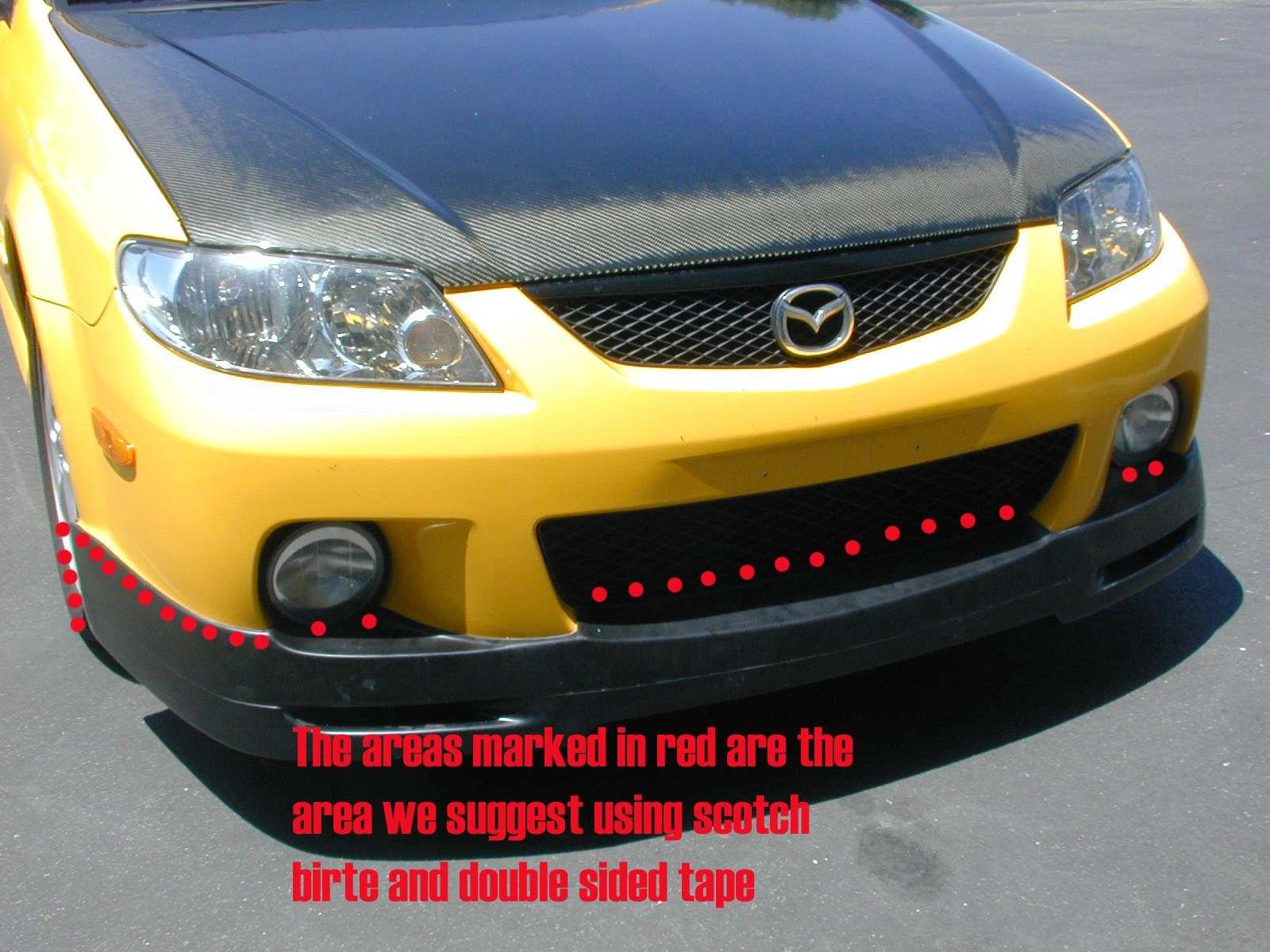

i kind of agree with mp5 that its needs to be installed right. im not saying there arent problems (because i cant see your lip in person) but mine looked like s*** before i went back and installed it correctly. the trick is a s*** load of scotch outdoor 5lb tape in a roll (which costs all of about 3 bucks at walmart). once i loaded up the front and sides with that tape (which sticks like a motherfucker no matter WHAT weather, im finding out now that i sold my lip and trying to remove the leftover tape) it looked very good, and at shows and in social gatherings i never got anything but positive comments. then use two self tapping screws per side to pull in the fender sections.

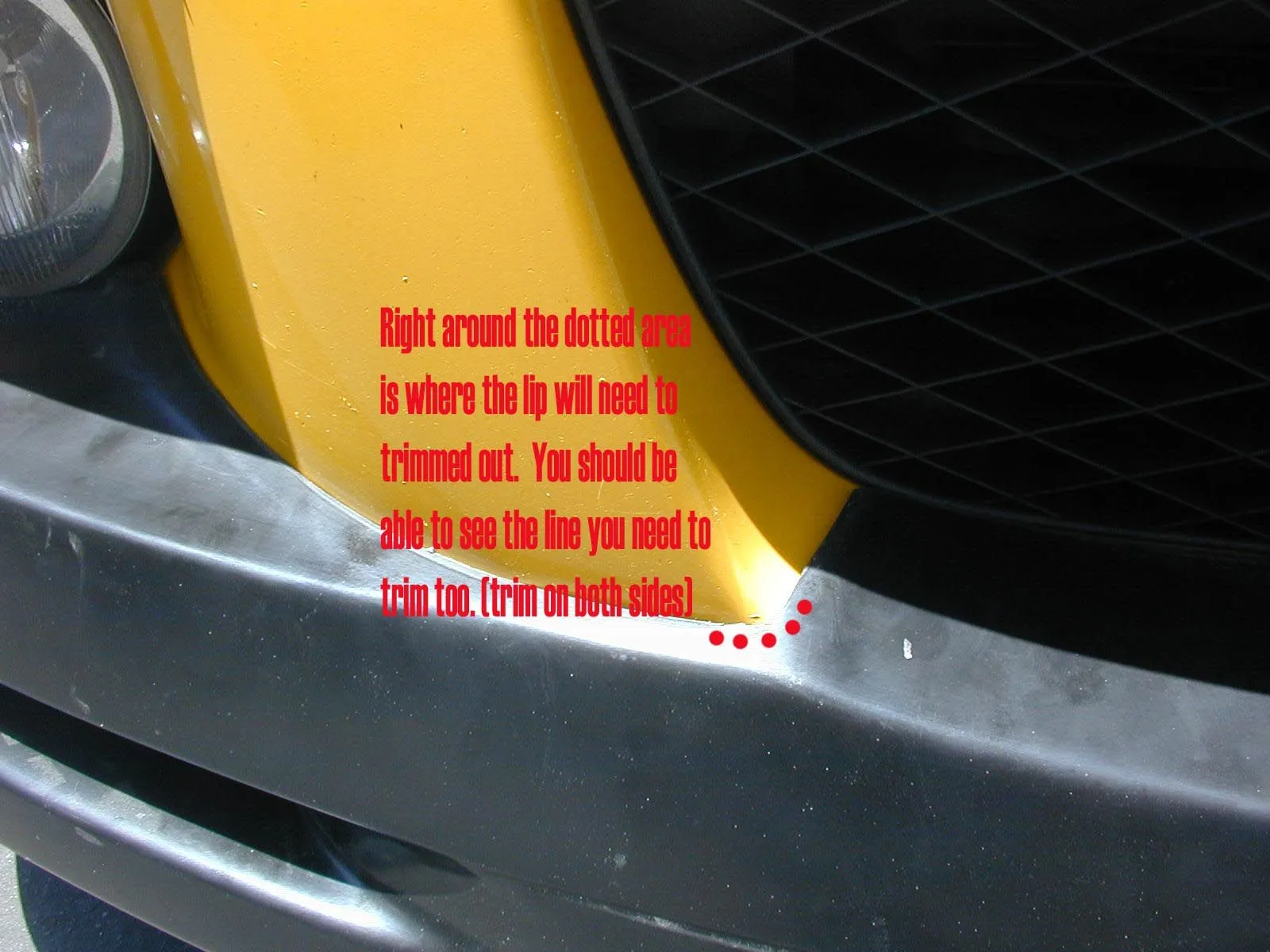

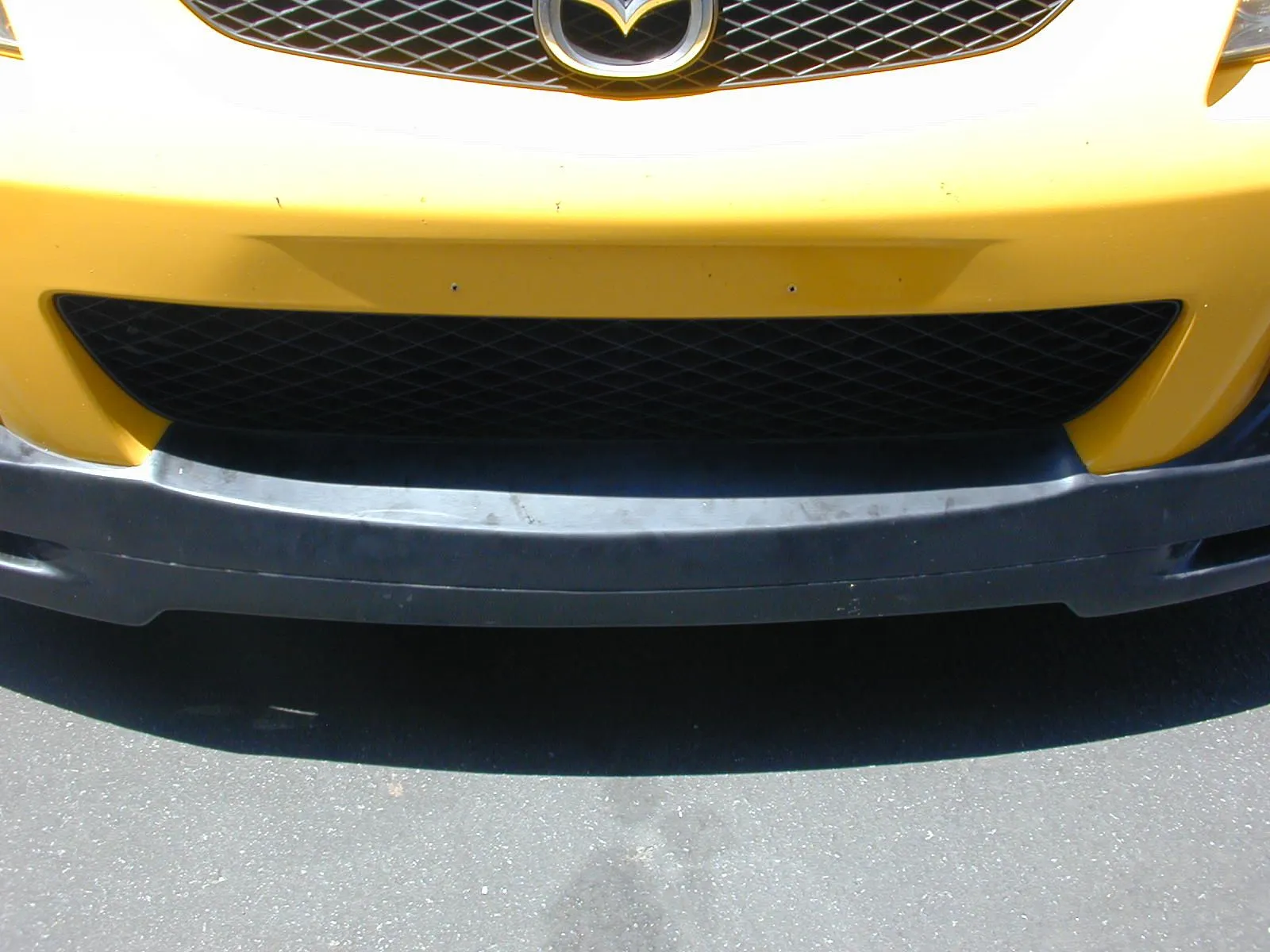

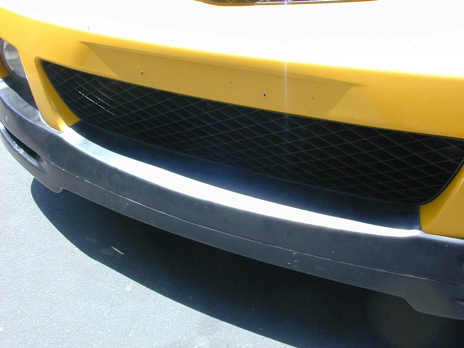

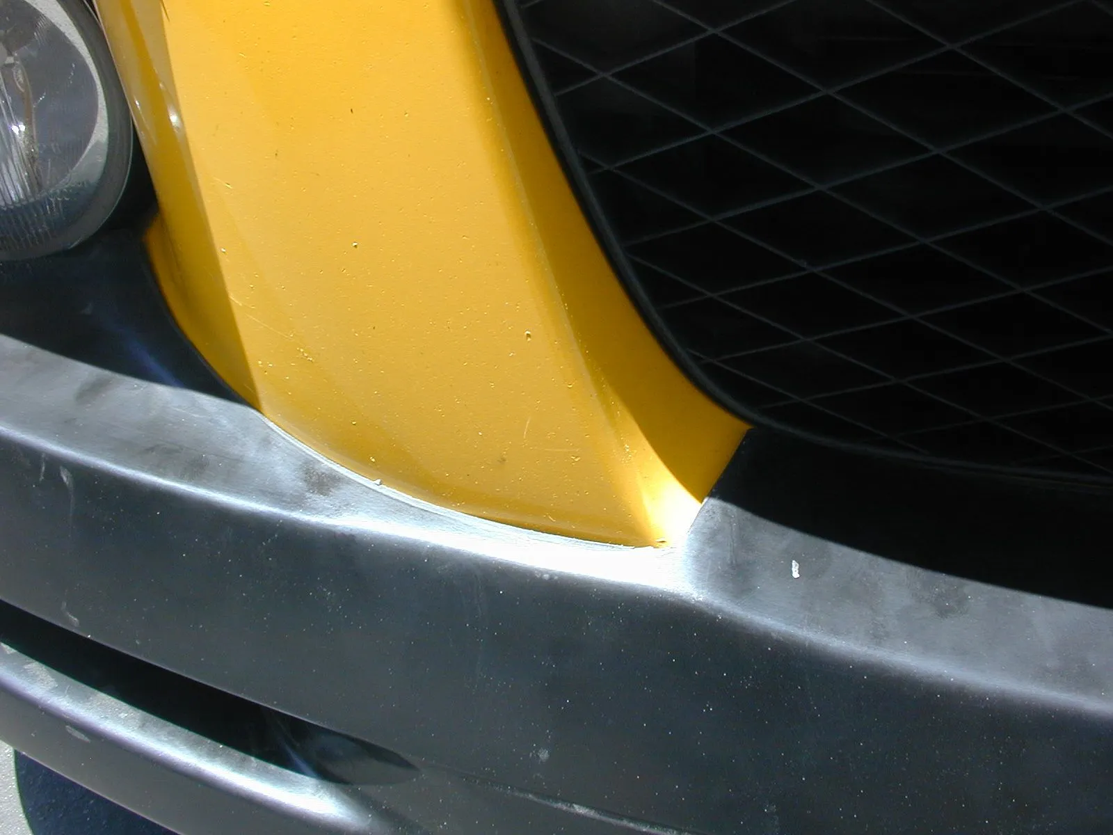

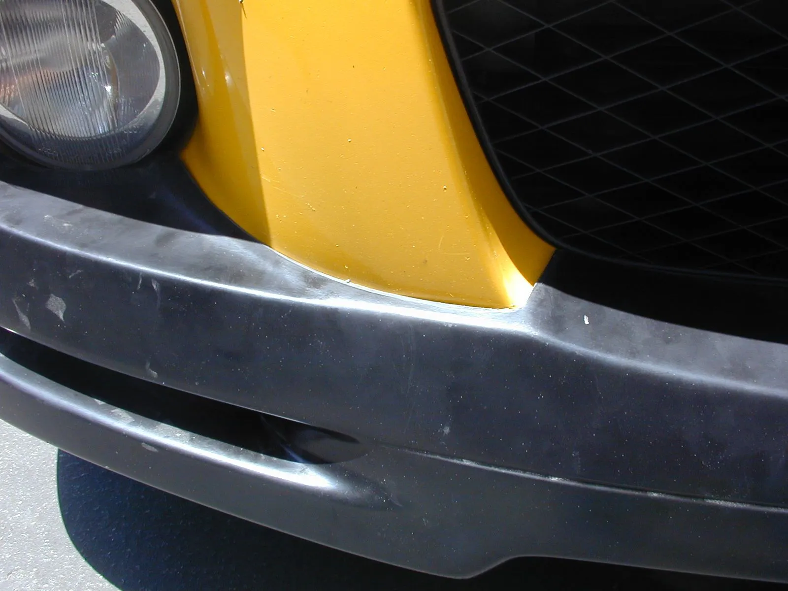

Well we just finished the test fit with (very minor sanding) below grill area we have a perfect fit..... I would assume the one's who have a good fit took it to a body shop to have it professionally installed..... I will be posting pictures shortly, for the people who have a poorly fitting part I will show you where you will need to sand. We will be trimming the ones we currently have in stock... As for the problem some of you are having with the mold release you have to use a scotch brite pad and a cleaner such as acetone. That is what we did and we were able to get the tape to stick just fine. I'm sorry for the troubles some of you may have had but it was an easy fix, next time please notify our company and we will take care of it as we have just done.
Thank you<O:p></O:p>
picts
Here are the pictures of the test fit after minor sanding

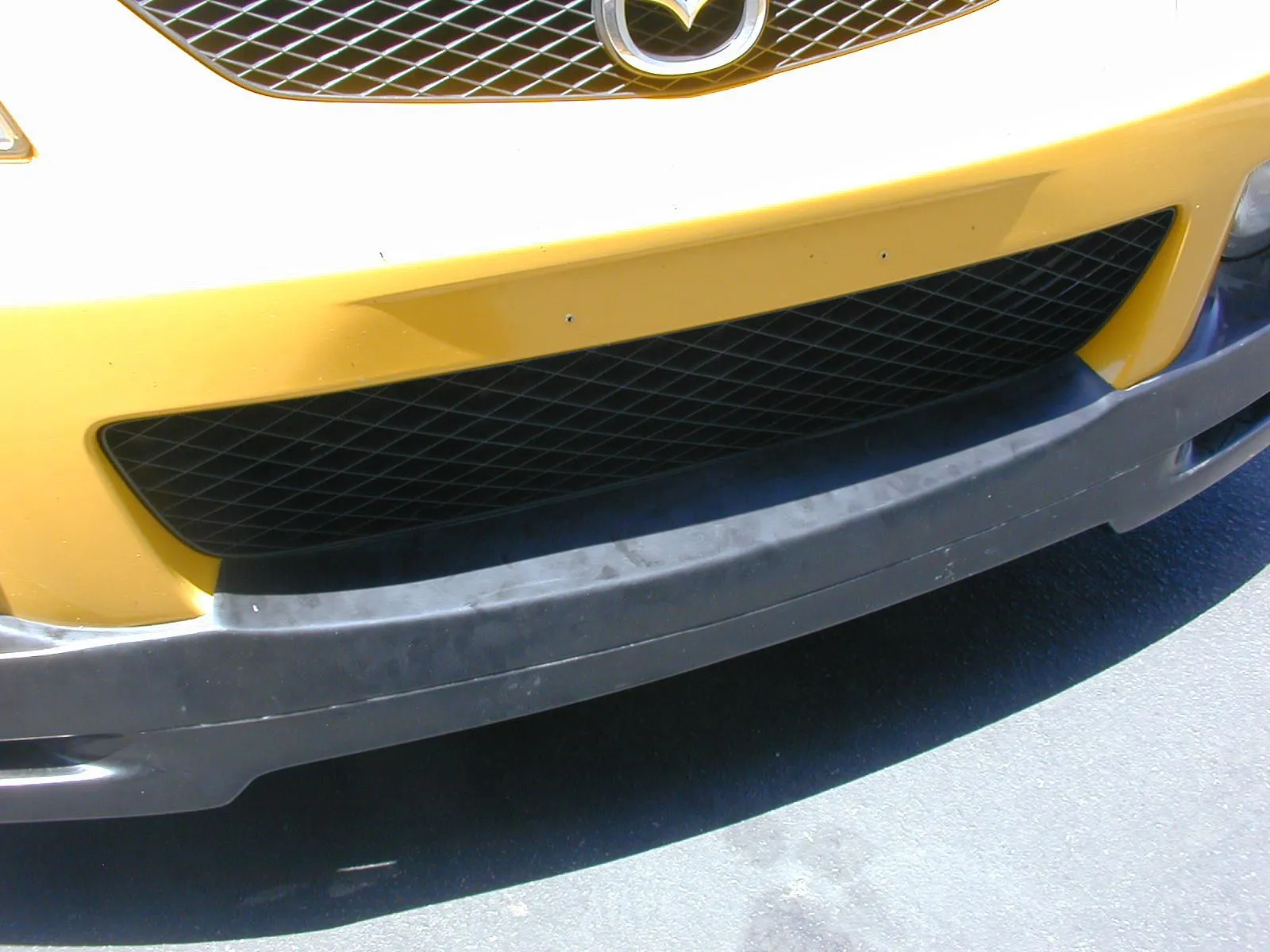

more picts
Here are more pictures

It fit my car well (in the pic). Thanks Amie, I hope to paint it soon and install it for real. It fit well as far as I could tell.
