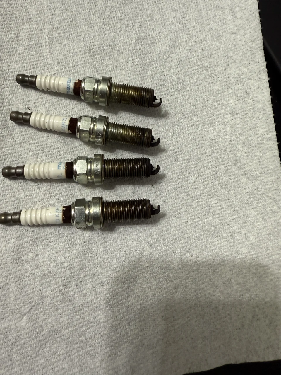

I have a picture of the old plugs. Will upload soon.
Please hold the coulda, woulda, shoulda comments. I just had a hip replacement and I'm not in any shape to argue.
This is 205k kms.
They look totally shot to me...electrode on the bottom one is almost gone and the gap on all of them appears to be way over spec.
I agree. Gap looks excessive, top electrode worn and plug carboned from poor combustion.
