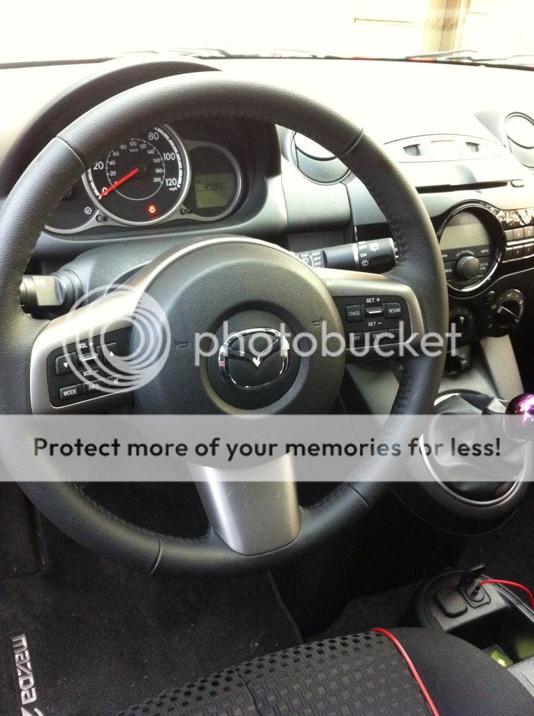

of course i've yet to take the steering wheel off the car and the center console out but i'll do that this weekend

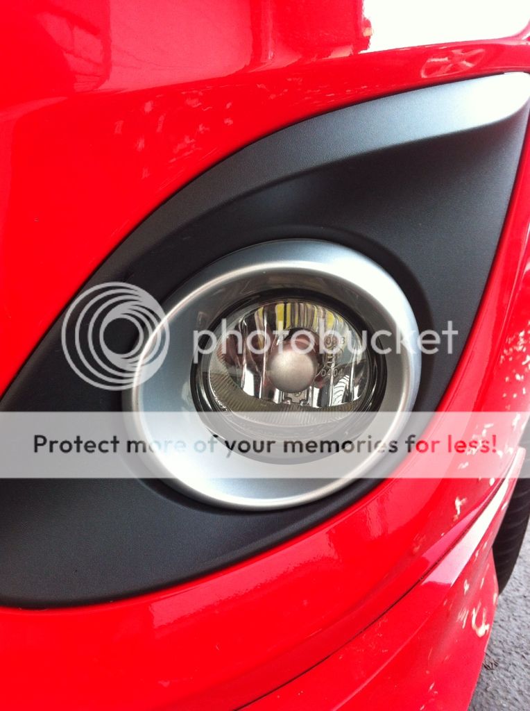

oh and the fog light bezel... i'll need to figure out how to get that out. will probably have to remove the front bumper
i want to take the fog covers out to spray them at work. but seems i have to take the bumper off to get anywhere near the screws.
does anyone know if that silver around the gauges will come off easily? if not i guess i'll have to find out!

Center console is really easy. Pull up on the front UPPER part (it's 2 pieces), you can access the screws mounting it down underneath. Fog bezel, you have to take the whole fog assy out. Don't need to take bumper off, just undo the splash guards to get your hands up there. There's either 3 or 4 tabs holding it in after you take the screws out.
