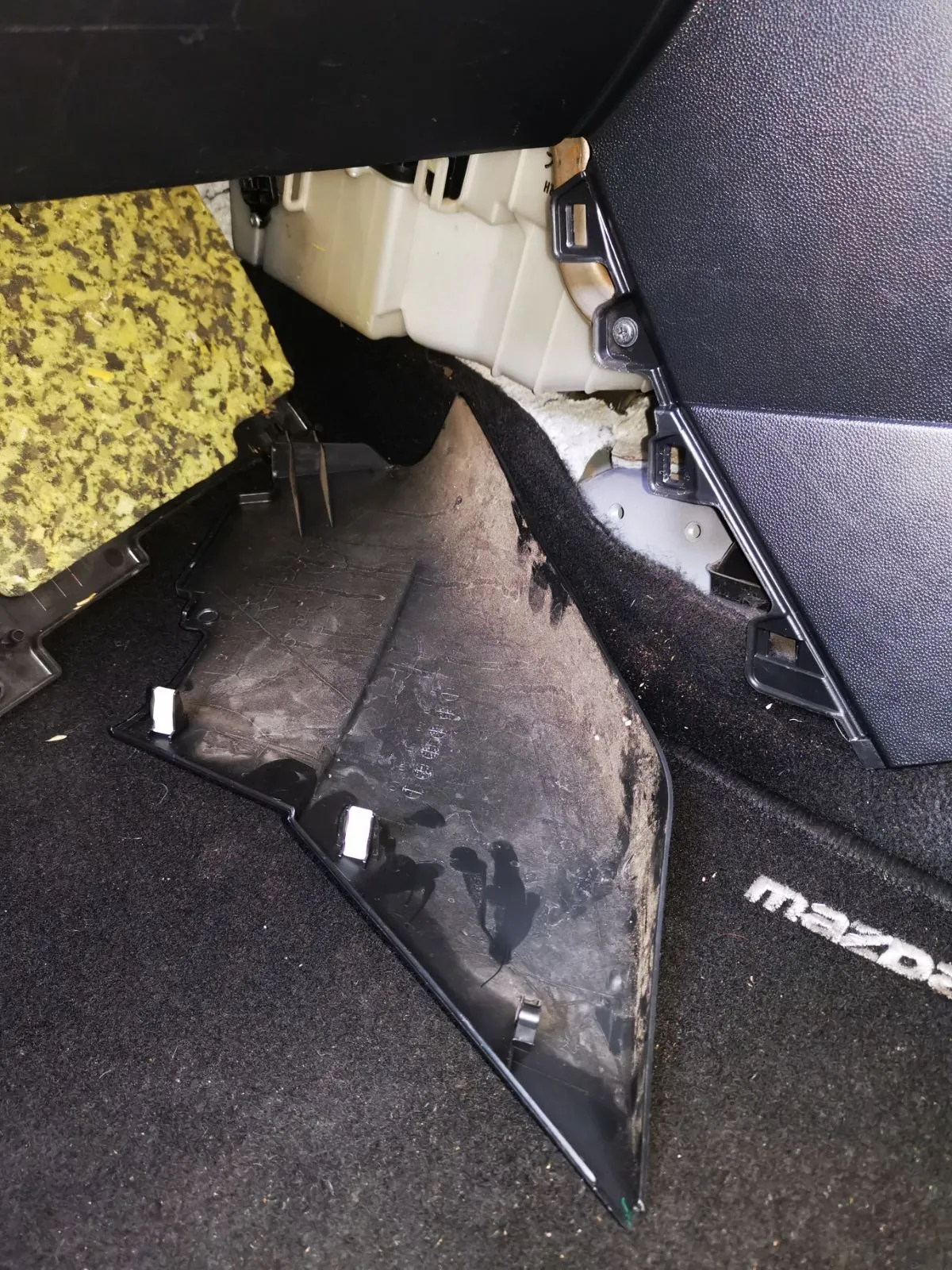

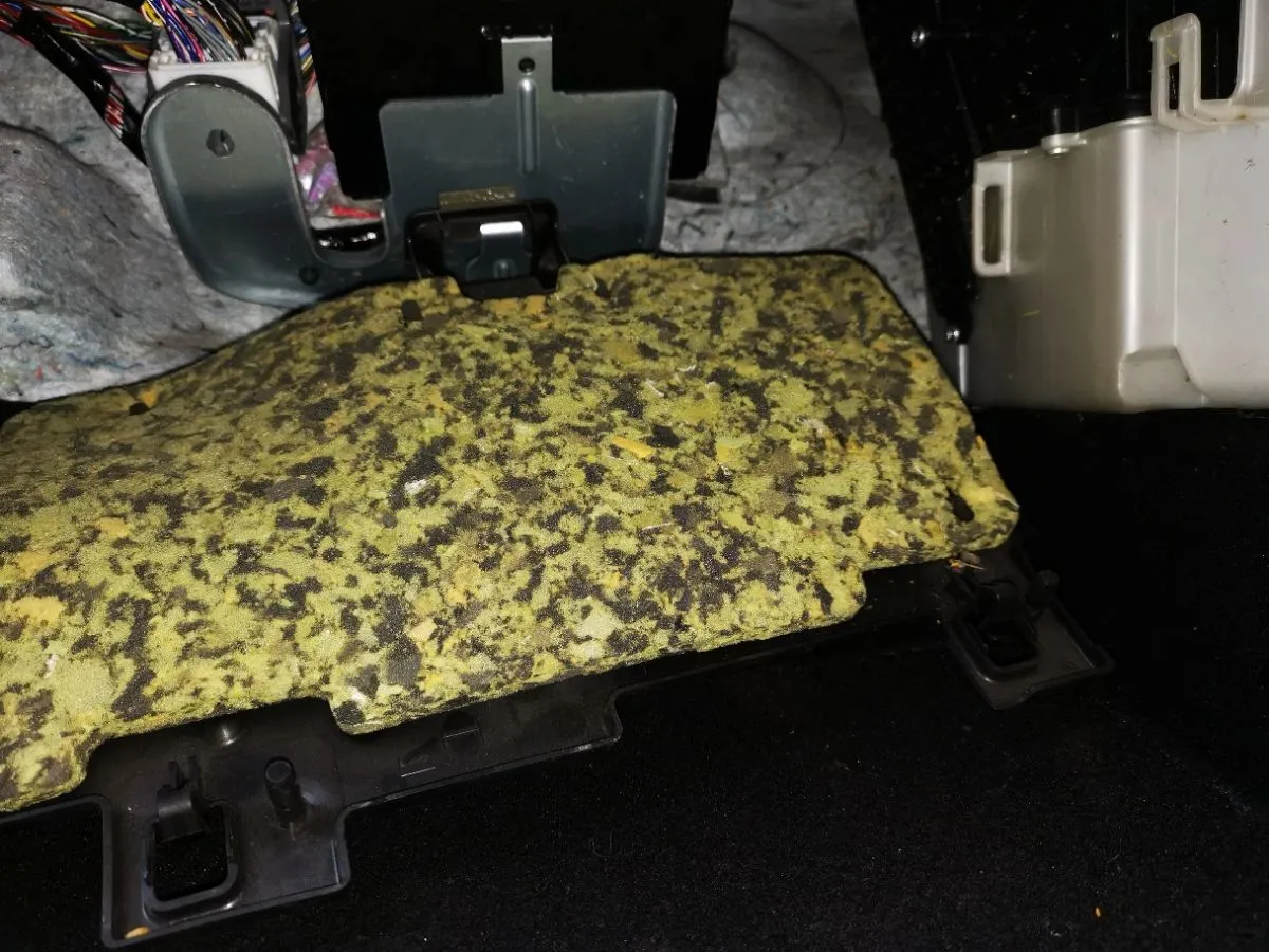

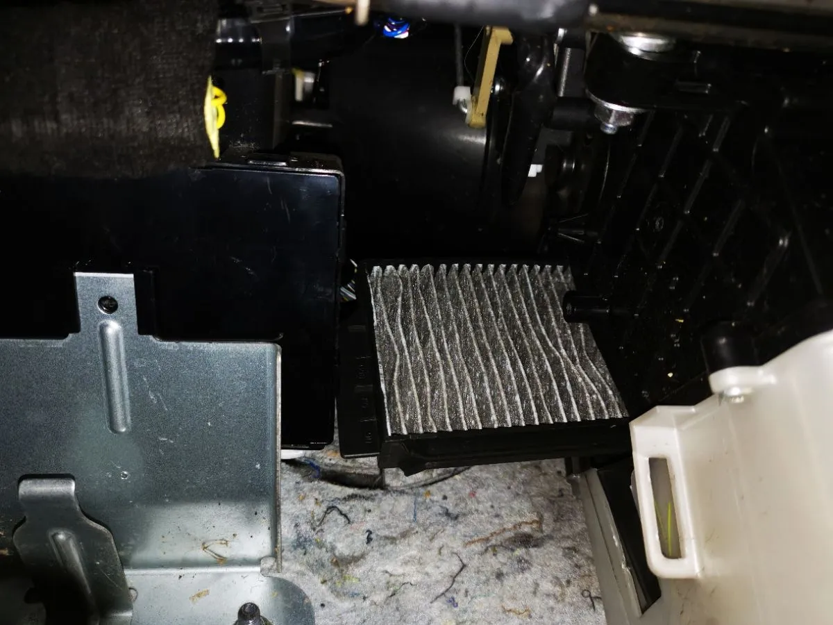

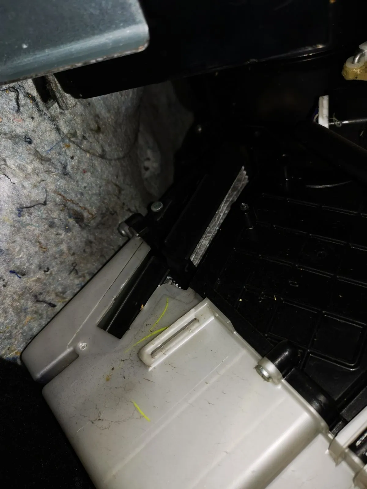

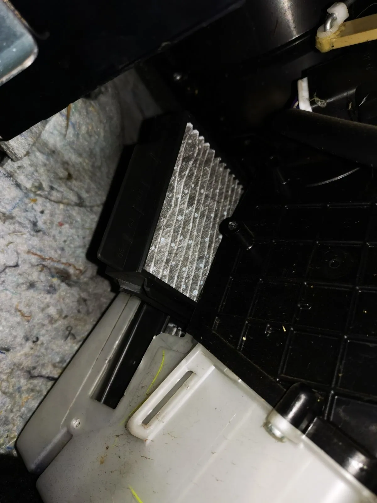

Hi I took some pictures from mine. Try from pass anger side, to get out easier is better to remove ecu as well. There is little cover on 4 screws, but mine is only on 2 as previous over must to lose.

Brilliant many thanks krisvr4 that a great help, been on several forums and finally got the answer lol. Can't really tell from your pictures but do I have to remove the glovebox, obviously for ease of access I guess yes but if I can bend myself into the space do I actually have to. Also how easy is it to remove the ECU
No you don't have to remove glovebox just remove plastic cover by legs and another plastic cover under glovebox. There is no screws just pull them out. If you still struggle i will try to record short video for you.

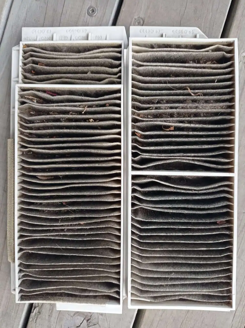

The video created by Krisvr4 was a great help :) I was finally able to change the two cabin air filters. (My car was bought several months ago). The ECU under the glovebox was very hard to push aside though. I also had to contort myself and risk getting back and other joint injuries. This task is easier for a left handed person as the access panel is to the right. Finally, after a lot of struggle, the old filters were removed. As you can see, they were downright filthy!
The new cabin filters immediately made the airflow much stronger as the system was no longer clogged. The air-conditioner and heater are now functioning at a much higher level of effectiveness and efficiency. My passengers and I can now breathe clean air again :)
