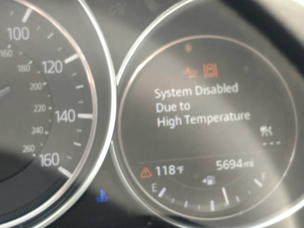

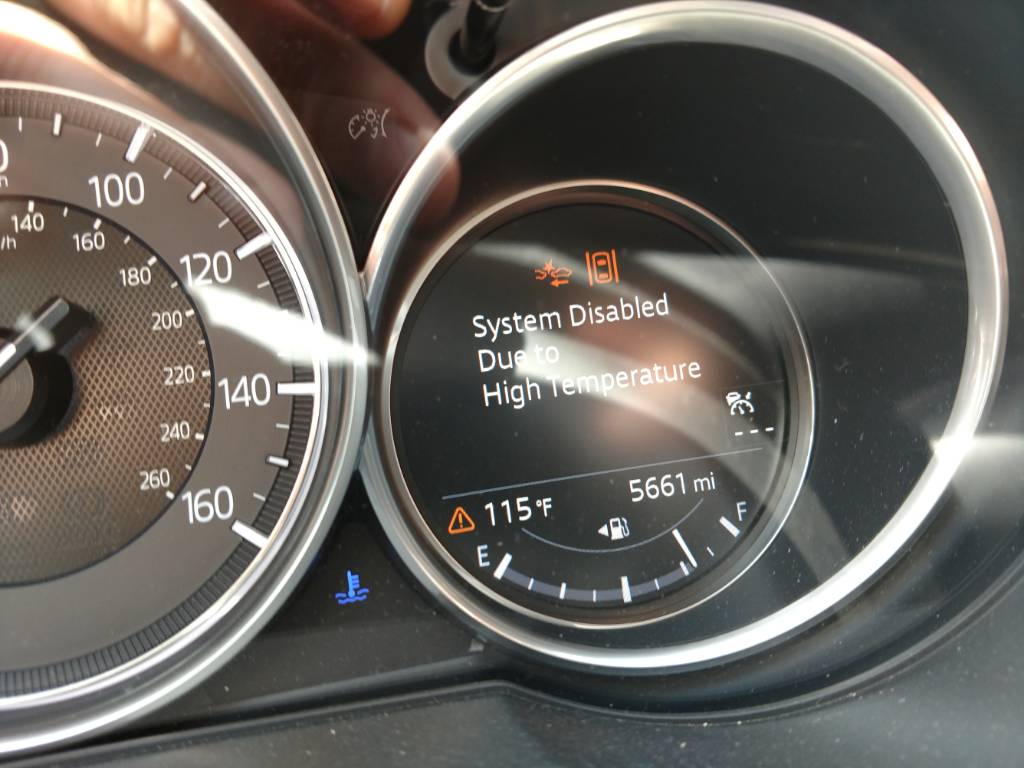

Just saw this today on my wife's brand new (less than 24 hours) 2018 Touring. The error actually said the system was disabled due to high temperature. I'm in South Florida and it's frigging hot outside so it made sense. The car had been parked for about 3 hours in the sun. As the car was cooling off the message went away on its own after about 5 minutes.
It'll be interesting to see how often we see this message, as it's pretty hot down here for a good part of the year. She also had one of those windshield cover things so I don't know if maybe that blocked some sort of ventilation to that area or something while the car was sitting.
Probably looked like this? This has happened twice now over the last month.
