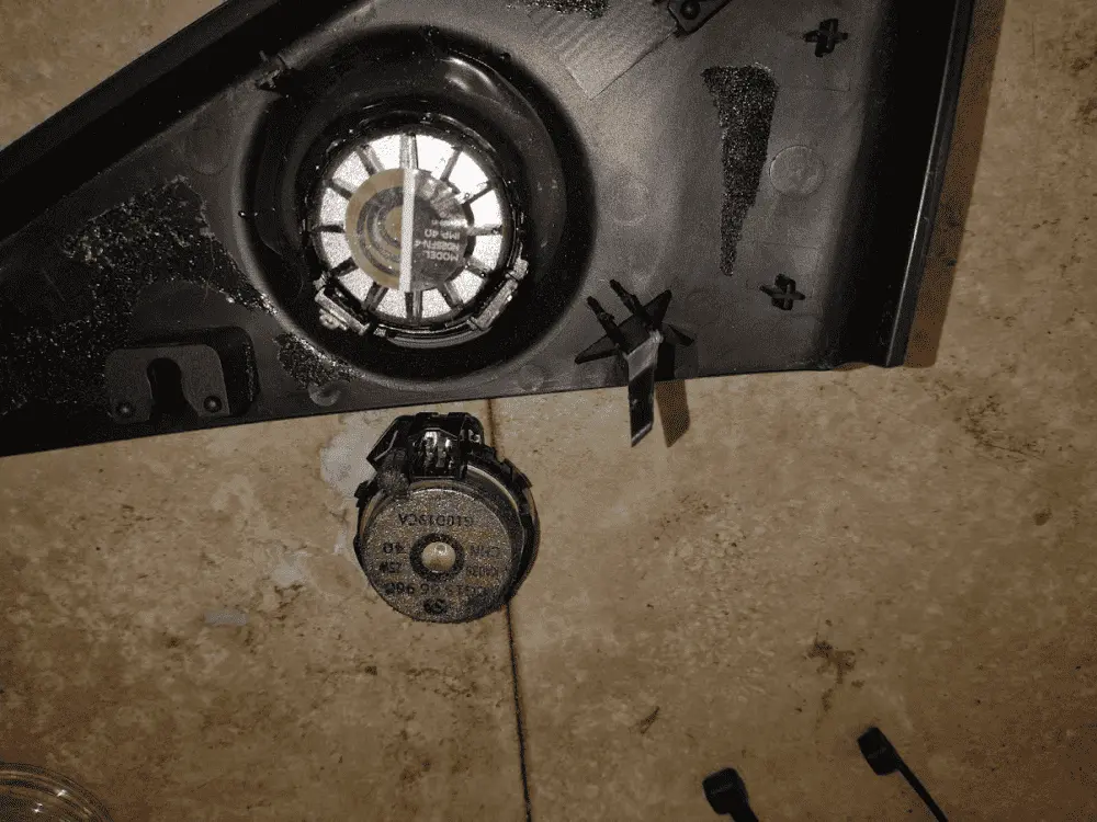

In the wife's Mazda, I put in some Dayton Audio ND25FN-4's. They fit almost perfectly in the factory locations. A small dab of glue from a hot glue gun holds them in perfectly.
Only $15 each, and for that tiny bit of money, they sound damned good. In her van, they are running active, so they get their own dedicated amplifier channels. The crossover I'm using is the Dayton Audio DSP-408 digital signal processor. If you're not running active, you could easily get away with whatever crossover your tweeters come with, or failing that, a simple $2 cap would suffice. If running a cap as a crossover, set the point pretty high, say 5,000Hz, because a cap only has a roll off of 6dB per octave. (You can look up what that means if you're not sure. Crossover theory is a rabbit hole that is way beyond the scope of this post.)

pic: Dayton tweeter vs factory junker in the door sail panel cover

I can also confirm the wiring is there on the passenger side but not the driver side. It doesn't seem cost effective to make two harnesses, especially when that is the only difference. All that is missing is the jumper from the main speaker connector up to the tweeter. Hardly worth deleting since the process of making two harnesses costs more than the connector and wire.
If you have a self service salvage yard nearby, see if they have a Mazda 2 Touring and simply cut off the main connector with a few inches of the wire pair from the amp. Then unwrap the harness to free the jumper that goes to the tweeter. Splice the main wires from the amp by matching the colors and plug the two connectors in and you'll be good to go.
Better yet, I released the individual wires from the center two locations in the plugs and swapped the one with the tweeter pigtail for the original without. I taped the pigtail to the bundle up to the tweeter and plugged it in. It works perfectly and sounds much better with actual highs, even with the original paper speakers.
