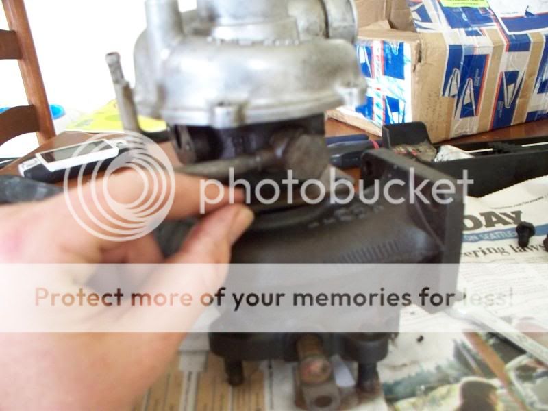

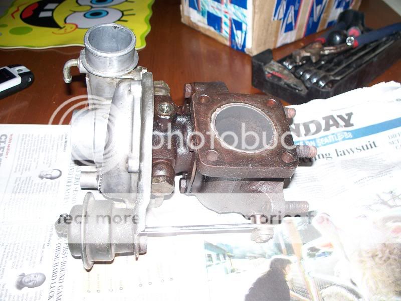

Spare VJ11

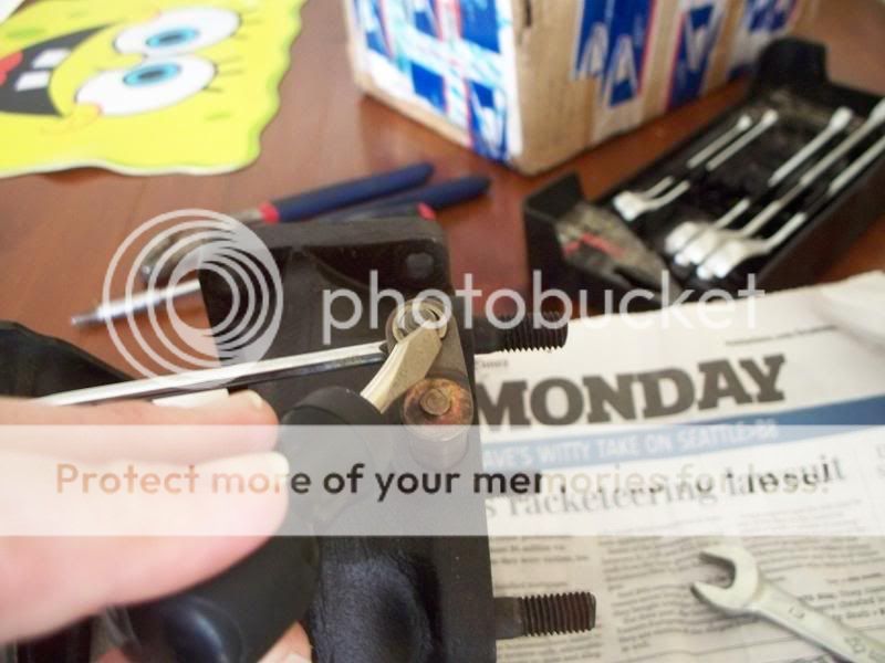

Unclip the wastegate

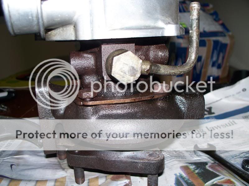

Remove the 6 8mm bolts that hold the cold side housing/wastegate onto the center section
Unbolt the 4 13mm bolts that hold the hot side to the center section

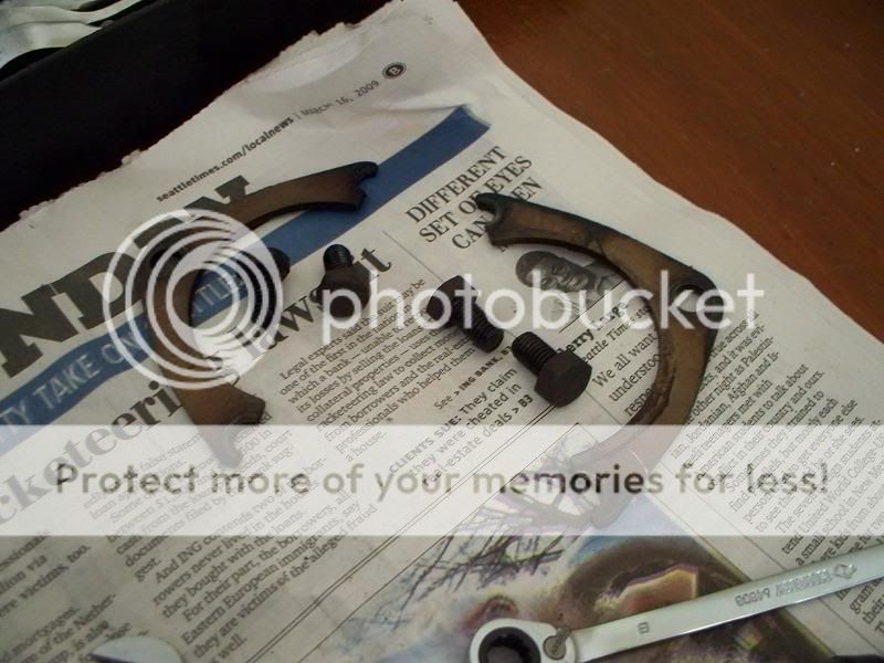

Remove these plates after removing the bolts

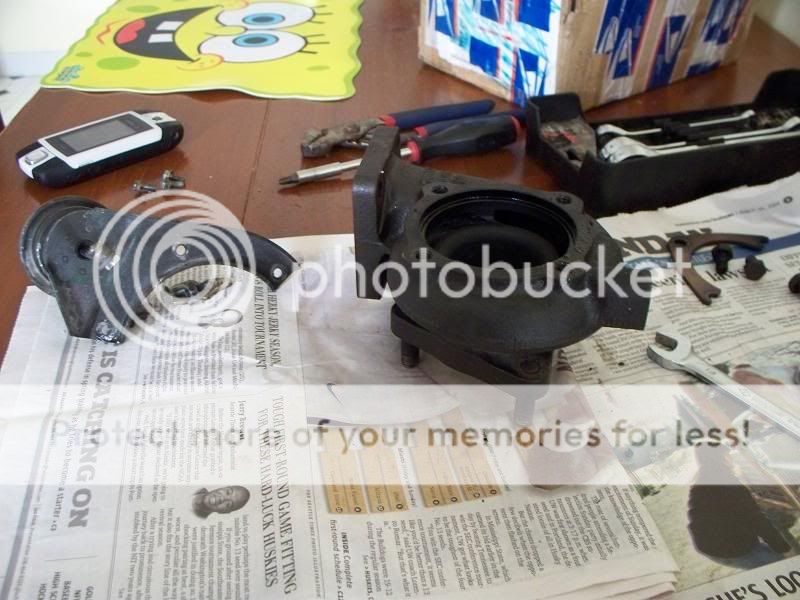

This is all you really need from the vj11

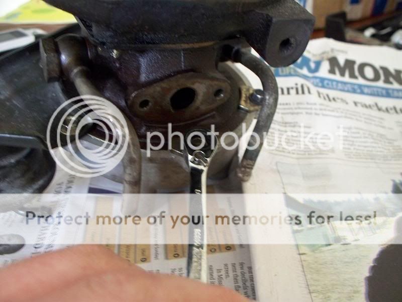

Bolt the vj17 center section to the vj11 hot side
Pic of it all assembled

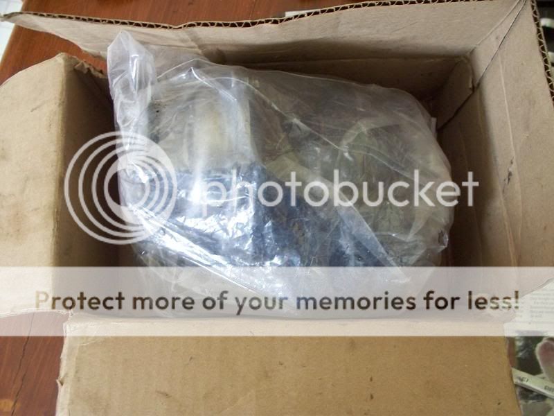

Packed away till further notice
I still have to tap the oil feed hole to accomidate the vj11 restrictor. If someone else has a better way(using differnet fittings for the turbo and block with a ss line) let me know.
