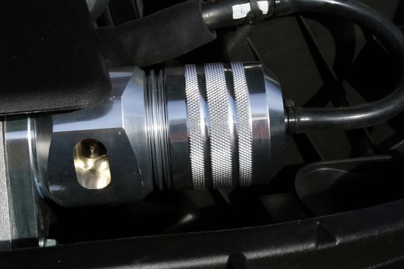

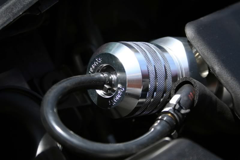

{UPDATE}----Hey guys, I just got the BOV put in this morning. Very easy to do and man it sounds awesome (omg) Here is a video that Jermaine (employee at Turboxs) linked - http://www.youtube.com/watch?v=nCMtBtl6vkc) which is better than what I have, I only had my phone to record video, which is useless.
Its not the loudest BOV I have ever heard but it sounds really good. My friend has a GTI and has the HKS BOV which has a higher pitch sound to it. This one has a deeper, more aggresive tone to it...hard to explain but I think just about anyone would love it :) Here are some pics, I hope to possibly get some vids put together next weekend of both of our cars.

Easy old fellow, actually this BOV was produced and tested specifically for this car, so the engine would not run rich, backfire, foul plugs or shorten the life of the Catalytic converter. It runs in both VTA and recirculation mode and man the car feels stronger than ever..and sounds amazing :)
