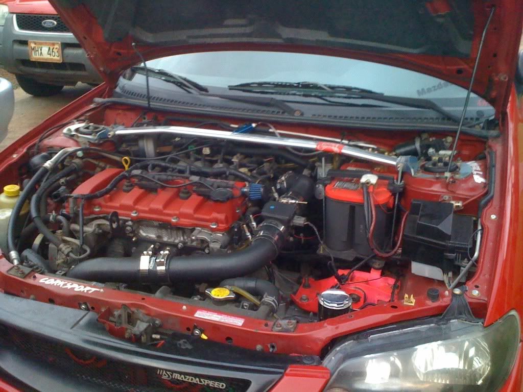

I would recommend going sc because if the reliability. I have a clutch on my sc so when im not racing at the track or going up a hill i have the SC switched off. Saves gas while still having fun. Its also cheap as hell. The only real down side is that you loose the A/C.
The hardest thing would be sourcing the bracket. It wouldnt take much if you could make it yourself though. Its actually quite simple. You will also have to make an inlet and outlet plates as well.
Parts list.
SLK230 Clutched supercharger ($100-$300) (Fudamsp has one for $100 ish)
Piping, couplers, clamps ($50- $100)
Inlet, outlet and mounting bracket ($100-$300 Depending if you do it yourself)
Engine management (Im using a SSAFC V2) ($250)
Bov, adapter, welding ($100-$275)
The things that are different from the Mr.Speed kit that I have done is a custom larger crank pulley puts me at 9.5psi (with the stock pulley you will only make about 3.5-4 psi)
Wrx 440cc injectors, and in air to air intercooler. I have yet to dyno the car though. Im waiting on a new intake manifold that I will port and polish.
This is what it used to look like before the intercooler
If you have any questions about SC let me know.
-Cres
