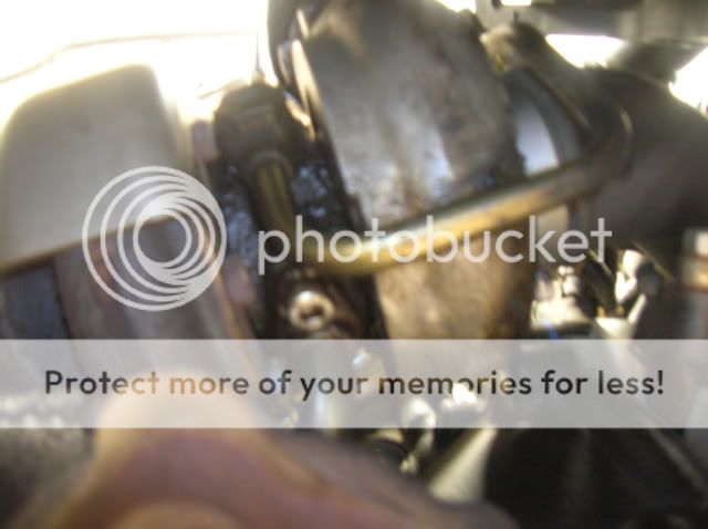

i have a leak from my turbo oil return line and we have decided that it is the oring in the part that has the allen wrench heads on the turbo(sorry if confusing) How hard is it to replace the o ring? pic that might help describe what im talking about.
you can kinda see the allen heads and the oil all over it
I ordered the oring today and it will be here tuesday. any other suggestions? i am just trouble shooting. i really dont think its the turbo seals(i hope not)
