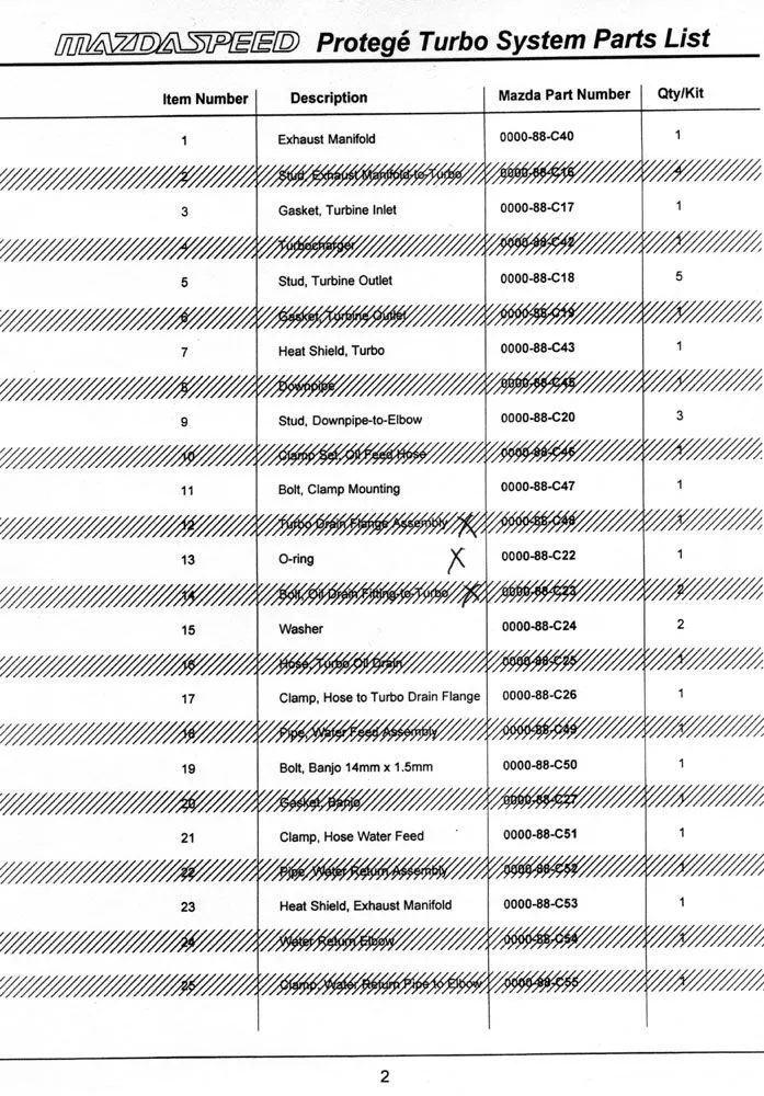

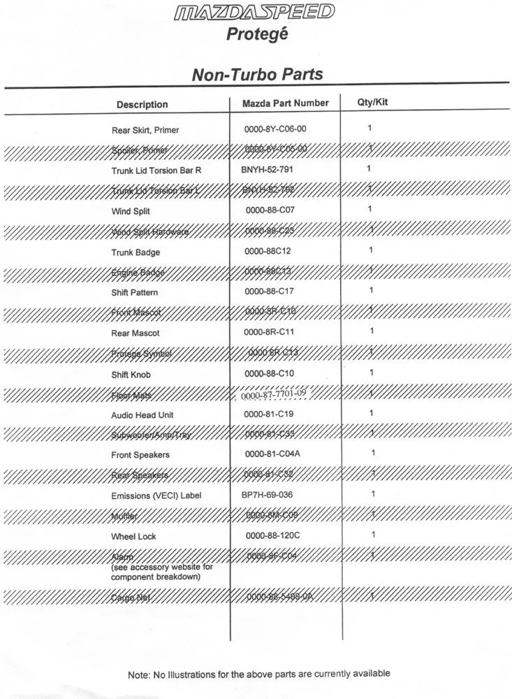

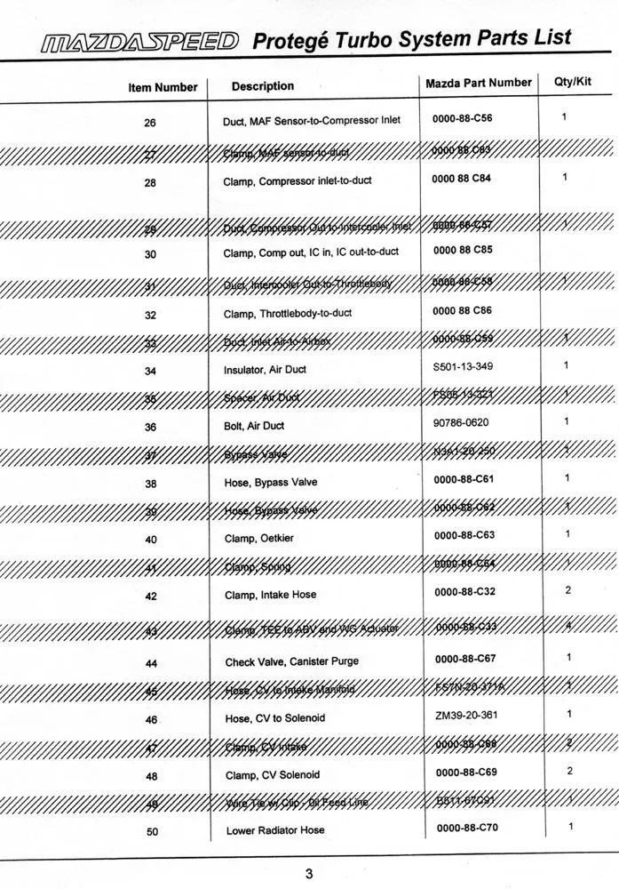

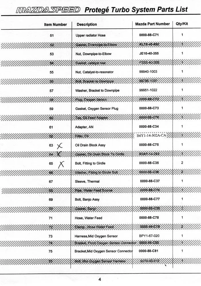

Ask and you shall recieve...parts list for the mazdaspeed components. The second pic lists the cosmetic parts specific to the MSP, the last 4 are the actual mechanical parts.

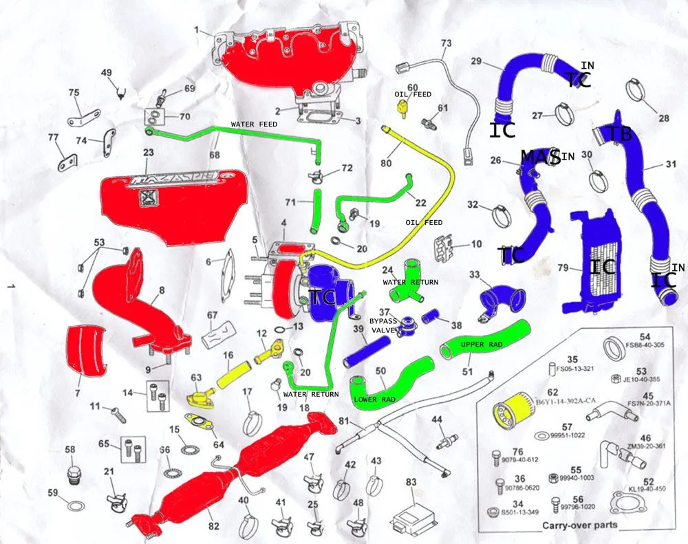

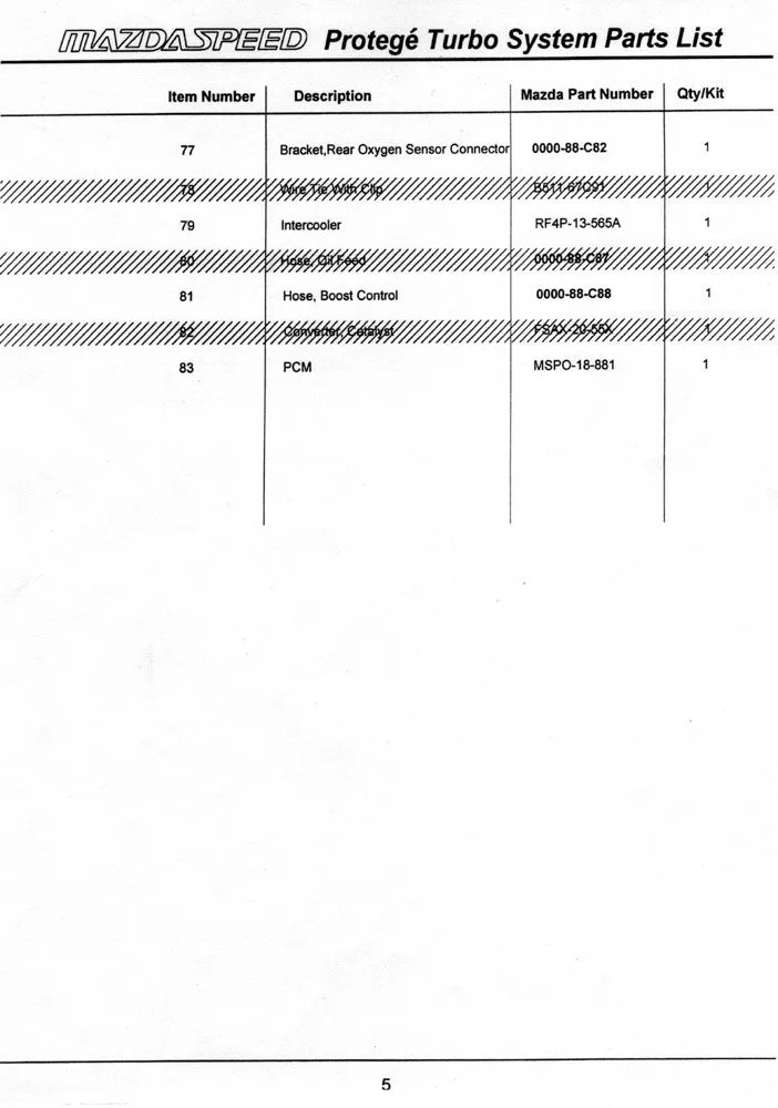

One more...

you know that long line with the threaded pipe, that i said goes to the oil cooler, youll need to run a hose from there to the turbo water line, so u dont have a hole in the loop, otherwise u wont be cooling the turbo which would be bad. lmk if u need anything.
edit: and what my opinion isnt professional now? haha
Thanks again Tony, and of course your opinion is professional, I just like to hear different opinions from fellow msp gearheads. ;) I know what you mean about completing the loop. I have an extremely intelligent mechanic friend coming by tonight to decifer my madness, lol, so he should be able to show me how to avoid having a hole there. And Schiesskopf, a HUGE thanks goes out to you for the major parts! ;)
I know i was kiddin. :)
youll see what i mean. you may need to just cap off that fitting or soemthing. i dont remember exactly where it goes but youll see the hole for sure.
edit. ok the long one goes to the turbo water line, the other turbo water line goes to the J. so alls u have to do is cap ooff that extra nipple untill your ready. that fitting im talkin about is number 69 on ur sheet.
The oil lines are just to lubricate the bearings. Not really for cooling the turbo. And the coolant lines are to cool the turbo. There are some turbo's that are oil cooled like the T-series turbos. But the Garretts are usually water cooled.
