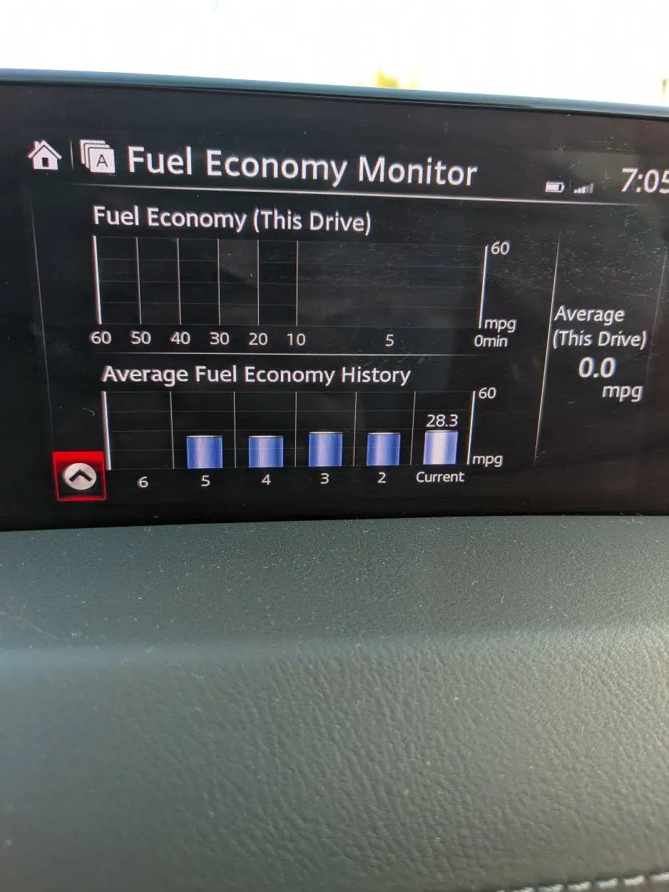

I had new tires put on a few weeks back (continental lx25). Pressure is excellent (around 39psi). The car says my mpg is 29 but my actual seems more like 25. This is with mostly highway. With the loaner for 2 weeks on similar routes, it averaged 29 actual. Definitely concerning.
What do you mean that the car says 29 mpg but it feels like 25? If you don't trust the counter, what are you using to gauge your mileage?
30.5 mpg on trip to Outer Banks NC from upstate Delaware with a fully loaded car, dog and two adults. Roads were mostly four lane with an abundance of stop lights.
Avg speed was 65 mph and using radar cruise.
