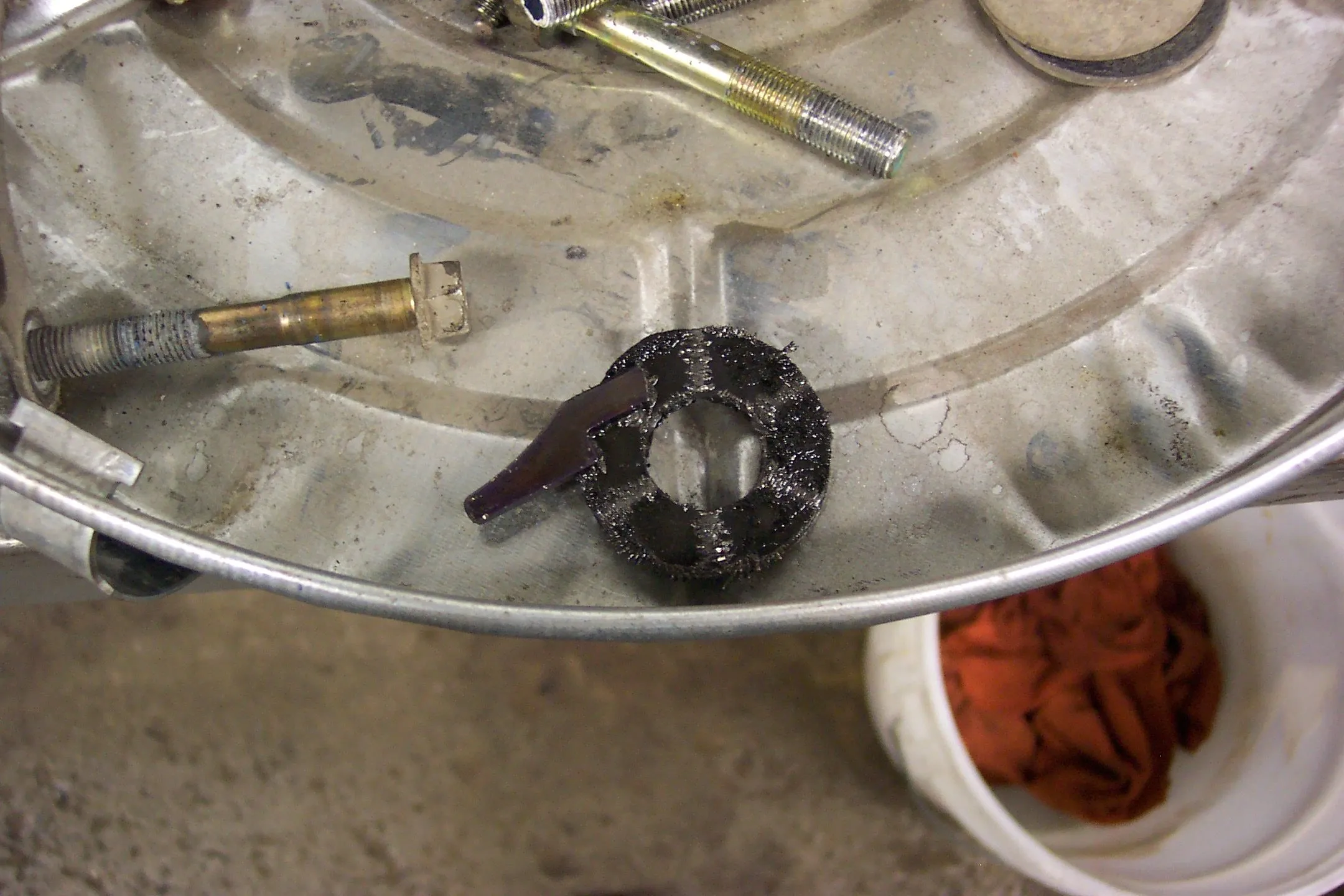

1st and 2nd looked good. Just reverse, and the lockout. I looked at the piece, it's a tiny little piece of metal (pic attached). I have to talk to the regional manager, they may and try to get me to sign a release, of which I wont. The metal for the lockout looks like it has a high carbon content, making it harder, but possibly to hard, and more brittle. there are no signs of where anywhere else on it to show that it was being forced (no dents where the actual shifter come in contact with it, no signs of wear..)

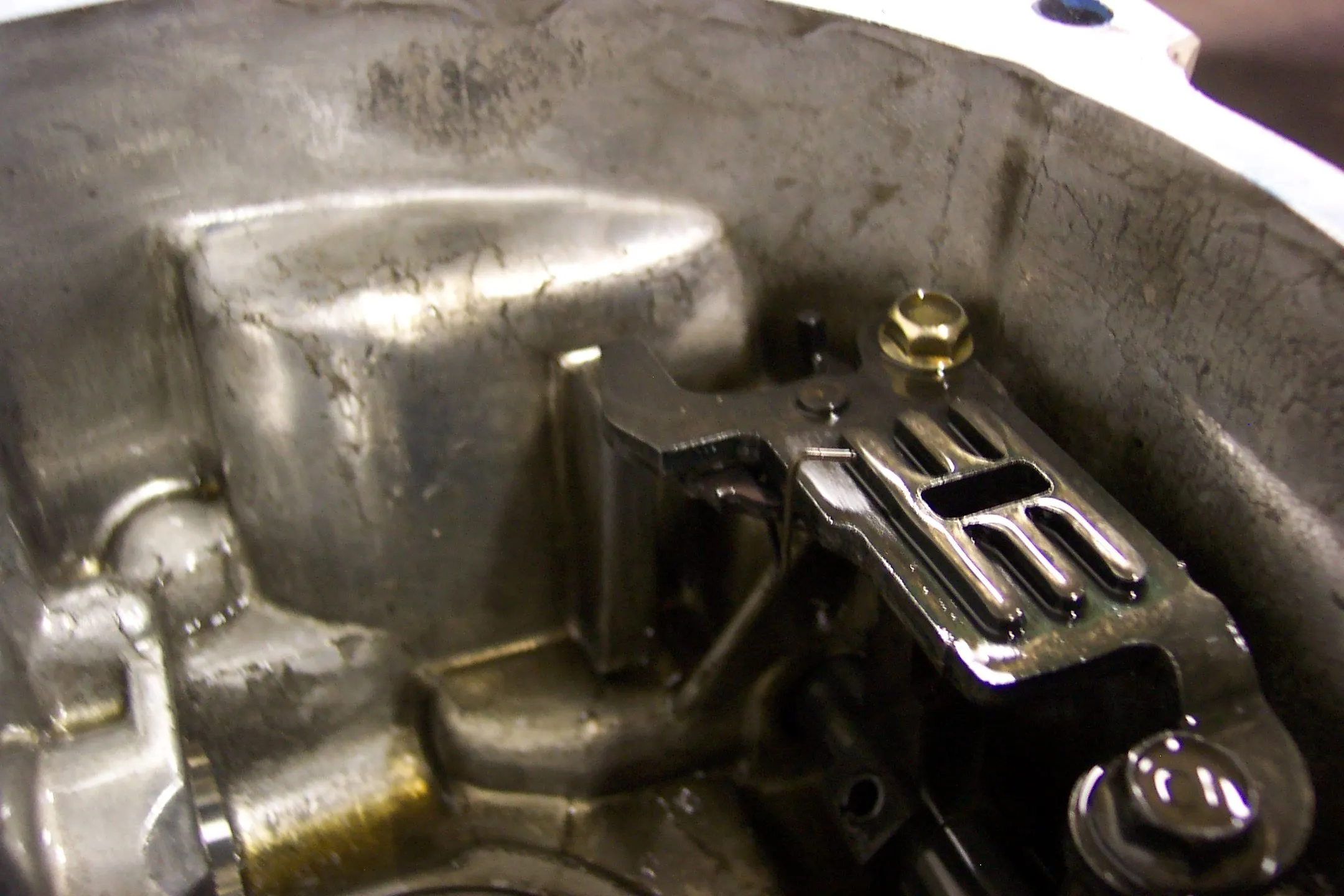

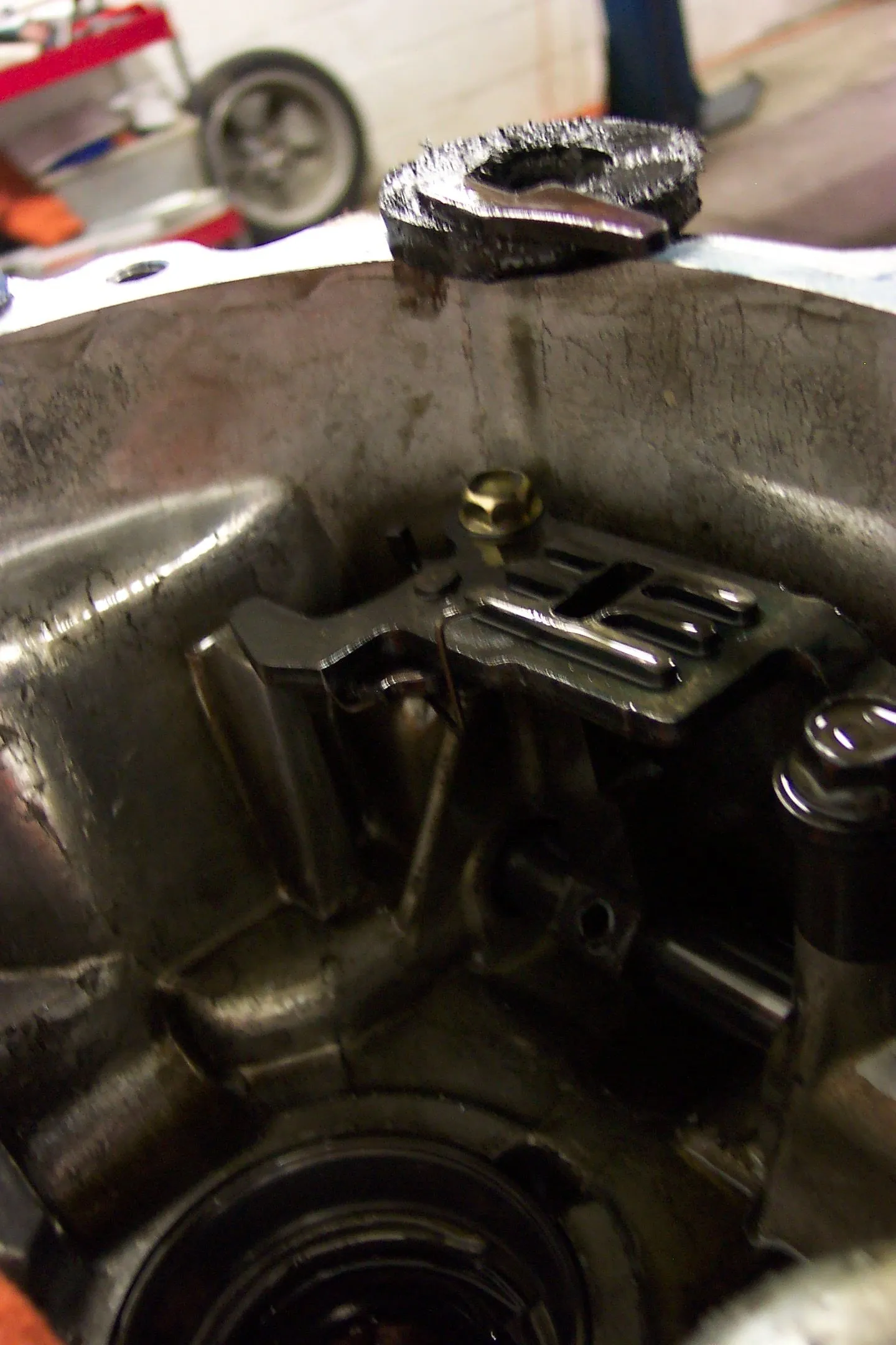

1st is lockout attached to magnet
2nd are the gates where the shifter runs through, and where the lockout goes to and broke from (where the spring is).

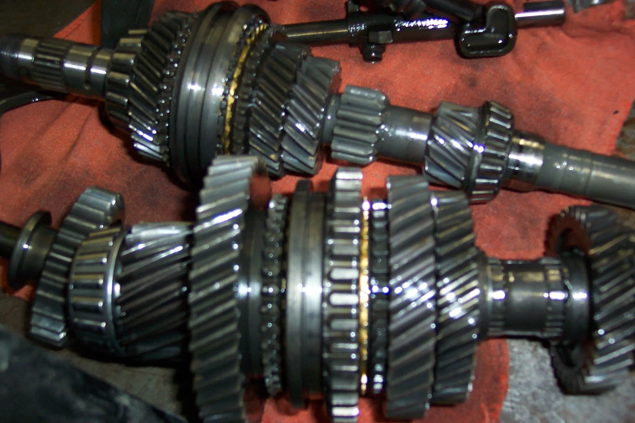

3rd are my gears.. Reverse are the only ones that are straight. Then the order from left to right are 1st, 5th, 4th, 3rd, 2nd (they are the agled gears). The gear on it's own on the left is the intermediary gear for reverse, and on the top part are the other set of gears (forget the order.)

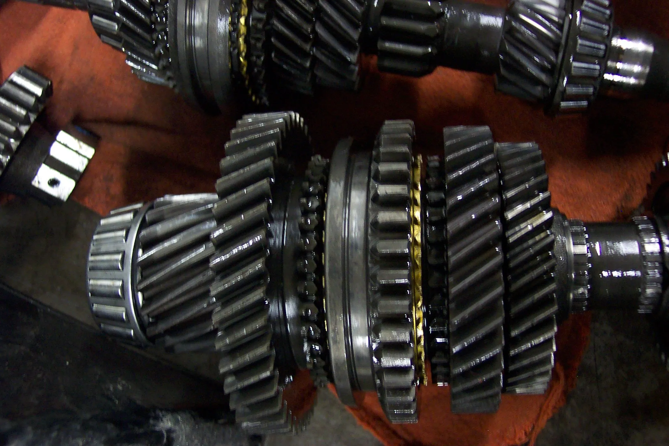

4th, pic of reverse straight on (it's the straight gear). This one is damaged because of accidental slipage @ high speeds, because lockout is broken.
Edit " I added a 5th pic of the gates and the lock out!"
So this time 1st, 2nd, and the synchro's and forks are all good, just the reverse gear and lockout.. I will get better pics of the lockout/fork tomorrow.
