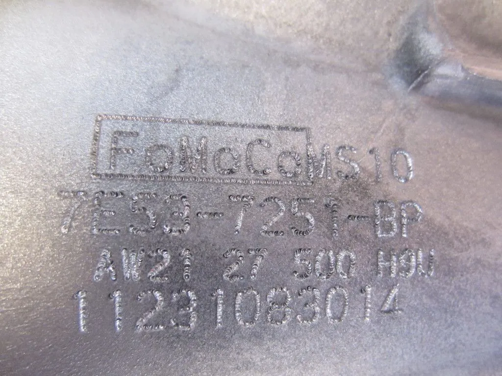

Then while searching eBay, I found the best clue. As the attached photo shows, the FORD P/N: 7E53-7251-BP WITH THE MAZDA P/N: AW21-27-500-H9U (a search of this number confirms that it is a valid CX-9 P/N) ETCHED INTO THE HOUSING OF THE TRANSFER-CASE. THIS WAS THE PROOF I WAS LOOKING FOR! FORD-MAZDA PN.JPG
I then looked at Ford P/Ns and how to decipher them, because Ford Codes information into their P/Ns. I found that there was a change in the Part Numbering System around 2000. This link will explain both systems: http://www.nospartsltd.com/Articles.asp?ID=250
This decoded the P/N as being for a 2007 Ford Fusion, not as a part for a Ford Edge. An eBay search for 7E53-7251-BP only returned the one exact listing, but did return several close listings for 7E5Z7251F. The 7E5Z7251F was listed a fitting 2011 & 2012 Ford Fusion (Model # E5), Ford/Lincoln Zephyr, Mercury Milan & Lincoln MKZ (Model # H6). Further research shows that this unit would fit 2007 thru 2012 model years. Please note that none of these models are not included in our earlier Ford Transfer-Case Interchangeability list for the Edge.
