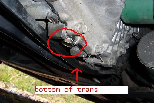

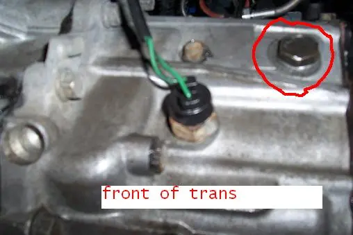

i also filled my tranny till it ran out the hole you fill it in. i used a funnel and a hose to put the fluid in.
