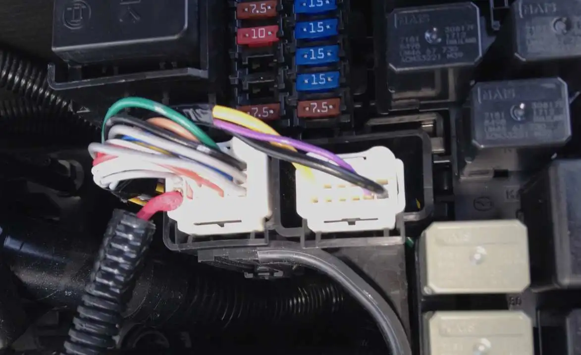

Wiring a converter with power.
I finally installed the Mazda trailer wiring package. It is a powered unit, and I wanted that for a couple of reasons.
The powered units supply a full 12 volts, the unpowered ones have a voltage drop because they need to run the lights through diodes to combine them.
More important, I want a separate fused circuit for the trailer lights to protect the car lighting from the trailer. I have had trailer lights short out and take out the car lights as well. Being on a dark rainy 4 lane with no tail lights or turn signals is not good.
The instructions from Mazda are good, but here is a bit more detail on getting the 12 volts. It turns out there is a unused wire running from the fuse panel under the hood to the back drivers side of the car.
Under the hood it is located where the big red wire is in the attached picture. Lower left of the left white connector. You need to push this wire with a connector on it into the plastic housing. Mazda calls it populating the connector.
At the other end, the wire you are looking for is Black with white dots.
I brought the flat 4 wire connector out into the sare tire area. Easy to do, no cutting. It is invisible when not in use. protected from the weather, and easy to get to.
