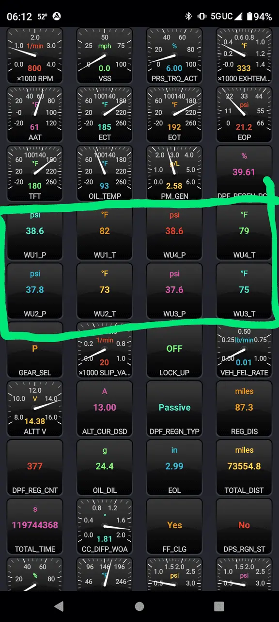

That's correct, but how does that compare to the newer system? When I reset the pressures from 39 to 35 psi, are the sensors in each wheel telling the control unit that 35 is now the desired pressure, or is the controller comparing each wheel's reading to the value it knows to be correct (in this case 35 psi)?
Each in-wheel sensor transmits actual tire pressure (and temperature). I imagine the "brain box" in the car has hard low/high psi numbers programmed to trigger the light outside of a range.
