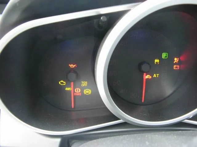

I have the GT-AWD and have no display for tire pressure monitor - even though the manual says it should show the icon when you switch to "ON".
Is that normal? How can I check that the car has this feature?
Windshield level, Fuel, Cruise, and possibly others - only show up when activated, but shouldn't TPM be displayed?
Are Canada models different somehow?
With a flashlight you can see each symbol, and where they should light up. The TPM symbol is in the left grouping near the top. It looks like in the manual - a U shaped tire with an ! inside. This symbol does not light up in my car when turned on
You should take it to the dealer. Something is wrong. It could be as simple as a bad bulb or there could be something wrong with the system. All CX-7's come with this.

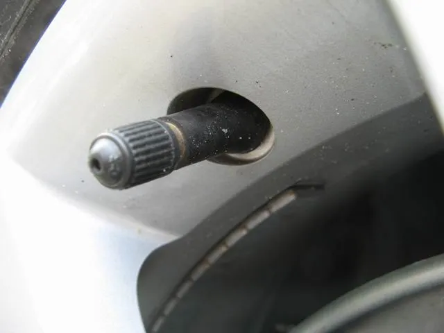

are you sure your car has TPMS? cars that have them have the metal valve stems not the rubber ones
This part of the valve is rubber.
Display of symbols.
<<are you sure your car has TPMS? cars that have them have the metal valve stems not the rubber ones
Why would my car not have TPMS? Don't they all?
Just spoke with the manager, who called back after talking with the service manager. They say it IS installed but will only display if there is a problem. Curiously, on the Mazda.ca site there is no mention of TPMS at all, but there is on the Mazdausa site.

Canadian-spec does not have TPMS
Yes, I was beginning to suspect this. The dealer & service manager have their facts wrong here. I did install the spare and drive around the block to check if the car noticed a missing sensor.
