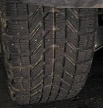

Here's what the snow tires look like:

Those Toyos are done with on the outside too. I think there are only a few tenths of an inch diff btw the inside and outside from the pic. The snows are also wearing faster on the inside, but b/c they are wearing down slower, you aren't really seeing it. Get a tread depth guage and check - you'll see there is a sleight difference.
Yea the inside of those snow tires look slightly more worn.
I wonder if it's worth spending $80 mid life to remount and rebalance tires so that the outside becomes the inside. Of course this is only possible with symmetric and directional tires.

Interesting idea to remount the directional snow tires 1/2 way through lifespan to even the wear; probably would be worth the cost and I'll examine the tread at the end of this winter. Sounds like a good reason to buy non-directional all-seasons (which I will be doing next spring).
