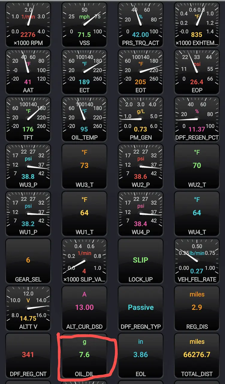

I have not used "torque app" but instead use "FORscan". On my 2019 North American 2.2 diesel, I usually see around 3.1 - 7.6 grams of oil dilution after a regeneration cycle that "burns off" or reduces through driving.
With FORscan, I can select various units of measure to display for individual pid's. That is likely an option with Torque as well.
Here's a screenshot of what I have set up for my standard "driving page" display...
The "Oil Dil Qty" pid is showing the "calculated" amount of fuel that made its way into the oil sump produced by the regeneration cycle. It goes up rapidly during regeneration and then reduces slowly (burns off) the fuel in the oil during driving which is calculated as well. If you do long high speed cruising, it burns off more rapidly than short city driving. The longer you keep the engine oil hot, the quicker it burns off
