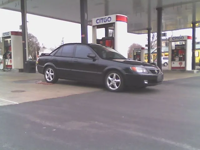

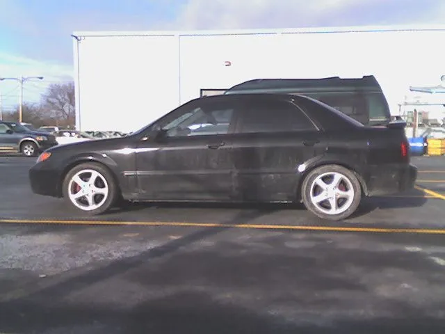

well, i took some crappy pictures this morning, since my car is so dirty from this winter resurgance.
I also measured the drop. Measurements taken fromt he wheel well lip to the center of the wheel:
Before:
Front - 14"
Rear - 14"
After:
Front - 13"
Rear - 12.5"
