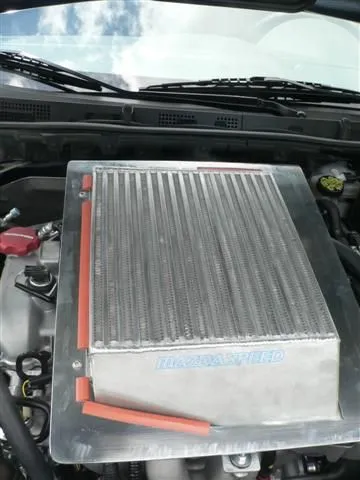

The quality of my 3.25" core seems fine The plate is another matter. After I trimmed the plate so it wouldn't bang on the firewall that is OK. I also added threaded inserts for the plate mounting so the plate is easier to remove without a bunch of fiddly nuts from the bottom. Finally, I added some rubber sealing strips between the plate and the core to reduce the amount of cooling air that leaks through the cracks.
