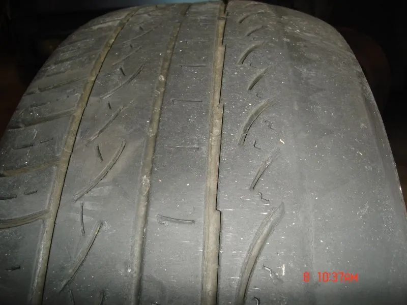

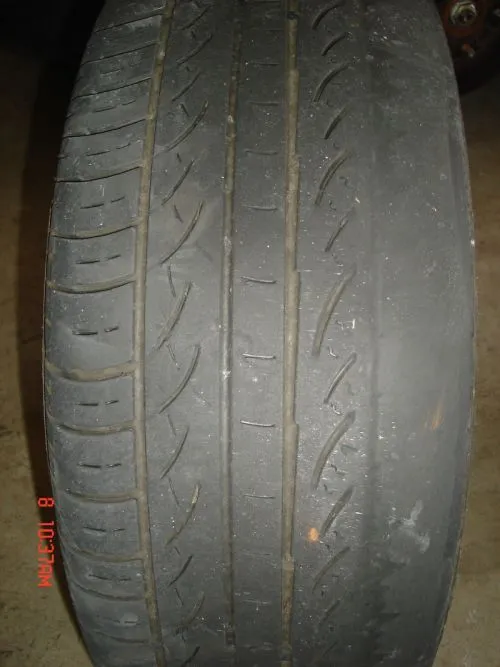

My MS3 has 50k on it and i'm about to go through my second set of tires. The stock potenzas lasted 24,500. I bought a second set of Pirellis PZero Nero which are on their way out at 25,500 with horrific inside tread wear which is most likely the neg camber is this the nature of the beast? The stock Potenzas have a UTQG of 140. The Pirellis have UTQG of 400 and they've worn out just as bad as the Potenzas. My driving style has remained the same.
So what gives. Pirellis aren't as good a tire? Or am I lying to my self about my driving style? I may lie to other people but I most certainly don't lie to my self. So I've been looking at the Potenza RE760 Sport. (pics below two worn Pirellis and the Potenza RE760s)

The PZero Nero is a quite decent all-season tire that by all rights should outlast the RE050A by far (it's not to be confused with the PZero which is a bad ass summer tire also with poor wear).
Are those front or rear tires in the pics? Do you have lowering springs? Was your car properly aligned? Did you ever rotate those bad boys?

Okay I got quite a bit to say so just bare with me here...UTQG ratings ONLY apply to tires made by the same manufacturer. For example, a Bridgestone P99* has a UTQG rating of 400, so it will have roughly double the tread life than say a Bridgestone B33*. But you can't compare UTQG ratings from one manufacturer to another manufacturer. For example, a Goodyear BK66* has a UTQG rating of 200 but it has just as long of a tread life as the Bridgestone P99* from the comparison earlier. Hope that helped one of your questions. Now, assuming that your wheel alignment is within spec, it is normal for your tires to wear the way they do. This car is made from the factory to have almost a whole degree of front wheel negative camber with a tolerance of plus or minus 1 degree. The rear also has enough negative camber to cause the tire wear you're seeing. This is the price everyone has to pay to own a car such as ours...
Here's the specs for the 3 basic alignment angles for the car:
Front *Unloaded*
Toe: 0 degree 11 minutes plus/minus 22 minutes
Camber: -0 degree 57 minutes plus/minus 1 degree
Caster: 3 degrees 8 minutes plus/minus 1 degree
Rear *Unloaded*
Camber: -1 degree 42 minutes plus/minus 1 degree
Caster: Rear caster is not measurable so there is technically no caster
Hope all that answers your question!
These are from the rear but my fronts are just as bad.My car is aligned properly it's been checked every time i had the tires rotated every 5k. No it does not have lowering springs.
HobDisease; "But you can't compare UTQG ratings from one manufacturer to another manufacturer." Well that explains it. "Hope that helped one of your questions." Indeed it has helped. Thanks! "Now, assuming that your wheel alignment is within spec," Yes i'm within spec. "it is normal for your tires to wear the way they do. This car is made from the factory to have almost a whole degree of front wheel negative camber with a tolerance of plus or minus 1 degree. The rear also has enough negative camber to cause the tire wear you're seeing. This is the price everyone has to pay to own a car such as ours."
