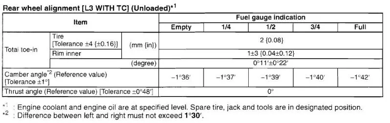

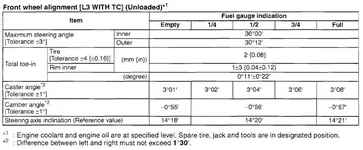

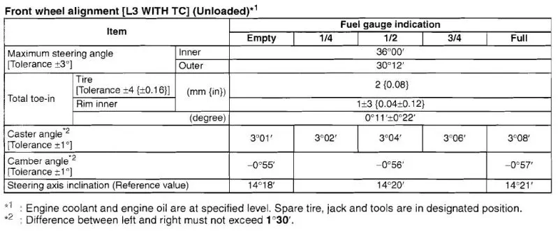

Attached are images from another forum which posted shots from the shop manual for alignment specs.
