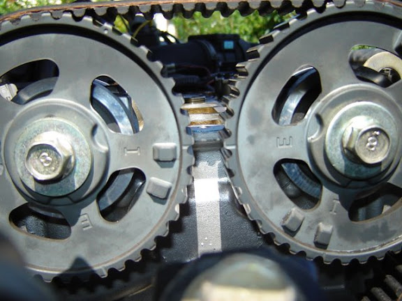

There you will notice the little toothed "wedge" that you are suppose to insert between the cam gears *before* you remove the belt. I didn't have that wedge either. When I put the belt back on, I didn't notice that the cam markers (that are supposed to aligned perfectly horizontal) had both moved downward a little bit due to pressure from the lifters. I was perplexed when I put the new belt on because I could not get the cam markers perfectly horizontal and the crank marker right on the mark at the same time. I then came up with the idea that you can see in in the "P.S." section at the bottom of my 2/8/10 thread. Here it is again for your convenience:
"P.S. I have some new pics and (hopefully) helpful comments about this job that I will be happy to post once I get over this last problem. In the interim, here's one about getting the timing marks aligned that (like myself) I see other people had problems with: The two slotted marks on the cams must be lined up perfectly horizontal (ie. not tilted down at all). I could not get the crank notch and these marks to align after tuning the crank four turns, until an hour later . . . I discovered that when you remove the belt, the cams are still under some tension from the lifters I suppose, and those alignment marks will move downward about one tooth when the belt comes off. You're under the vehicle trying to slide the belt over the tension arm so it will come easily off the crank gear, and you don't notice the cam marks have moved slightly. Following is a (after the fact) pic of my left hand and right hand pushing downward on each cam (not much force required). THE BELT SHOULD NOT BE ON AS SHOWN HERE! Have an assistant tap in a little block of wood to keep the cams sprung back in proper position once the wrenches are removed. AGAIN, DO NOT DO THIS WITH THE BELT ON THE CAMS! This pic was taken after I had put the belt back on correctly. And by all means, do not forget to tap out that piece of wood once the belt is back on the cams! Note that the cams can't spring back out of horizontal because they'd have to crush that piece of wood:
http://cid-0ba9610cbd3ba347.skydrive.live.com/self.aspx/Protege%202002/cams^_spread^_and^_block^_of^_wood^_inserted.jpg

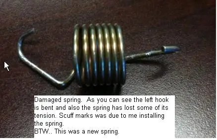

Slavrenz, Gozz and Brcobrem thanks for all your help! And documenting the how to do the timing belt job.
And Brcobrem great idea on locking cams in to place! Next time I will use this trick. I had my wife hold the belt on the exhaust cam, while I aligned the intake cam to install the belt.
The culprit was a "failed" spring. Maybe it was damaged by me during the install or a faulty manufactured spring. I used Dayco tensioner, roller and spring kit that I bought form Advanced auto parts.
As I said before. I drove the car for about 100 miles after installing the new belt and car was making the same power and everything was working smooth. I did rotate the crank confirming the timing was correct. Spring failed as I was going home from work. So I got the car towed to work because it was near by and I didnt have AAA coverage.
Next day I brought some tools to work and took off the value cover and saw their was tensioner on the timing belt and could not confirm the timing marks due to lack of light and me being lazy. Since there was tension on the belt, I thought the CKP sensor had failed and causing no ignition.
Last weekend I got the car towed home and took the belts off and that is when I discovered that exhaust cam had jumped by more then a few teeth and when I took the spring off, it was damaged. I got a new spring from Advance Auto parts and installed everything back and I have driven the car for about a 100 miles. Keeping my fingers crossed.
Next big thing that I have to do is install KYB struts on the car. I have a Air-Compress that I borrowed from my neighbor.
Thanks for all your help!
Deep

So now the problem... We aligned the cam pulleys as documented ... with the I on the Intake cam and E on the Exhaust pointing up... we then "fine" tuned them to align the "timing marks" horizontal to the head....
Now, the car won't start at all... doesn't pop at all... but we did not crank more than a couple seconds.
The problem may be that I did not align things properly.
So, do you think I should have the I and E letters aligned to each other?
the two little tick marks have to be facing each other and the crank shaft notch has to be facing up...at i'm pretty sure.
THANKS!!!
Each pulley has 2 (two) "timing tick marks"... Neither Tic mark is under a letter I or E. Which should I use?
Is it possible the pulley has been installed improperly on the camshafts?
BTW.. "Wooster" is my middle name! (I know, it has nothing to do with this problem ... maybe.. =)
The i and e stamped on the cam gears face eachother
The exhaust cam is the one closest to the front of the car, so that cam has the e on it and next to that e is a notch, make that face the intake cam marked i until both those letters and notches are horizontal to eachother
