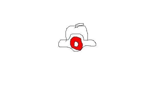

ok i noticed this when i got the wastegate a long time ago. why is it like that? the wastegate i had a while back was dif. it covered the whole area nicely. with tial it causes a leak since the thing doesnt seal all the way. i highlighted the area in red so everyone knows what i am talking about.

I have a Tial 35mm and it seals perfectly, I don't understand what your picture is. Can you please try again, we will get you an answer.

I'm running without gaskets. The parts are mathced and polished. Unless you have done someting to them, they should make a seal even without the gasket. My gasket burnt up and then stopped sealing.
Try it without if you think the surfaces are undammaged..
Tial Products are excelent and very high quality. The body is cast stainless steel and should not warp. If you have a gasket blown is because the flange is not flat or the bolts came loose. I use them without gaskets with machined flanges and work good with no leaks.
Make sure the flange is flat and use it without gasket and if you are returning to the exhaust, make sure you have a flex pipe in between as the parts will expand and contract at different rates.
are you talking about the metal ring? you ahve to shove it in there prior to install and make sure it doesnt fall out when you install the WG.

Not the ring, There is a gasket that comes with the set, It's metal and some other material. It fails quite often and is not required to make a nice seal.
yeah couldnt get pics. man i should have taken them when i had it off. the only thing is that if the dumptube was not connected it sounded like a diesel truck. the thing is that when i had my old one it didnt sound loud until boost. since the diaphram opened up. i will try to get them next week.
