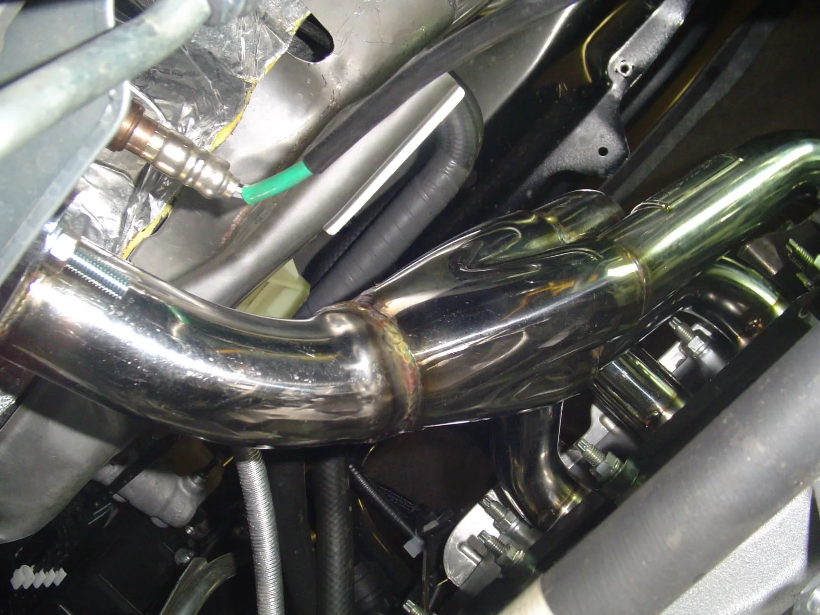

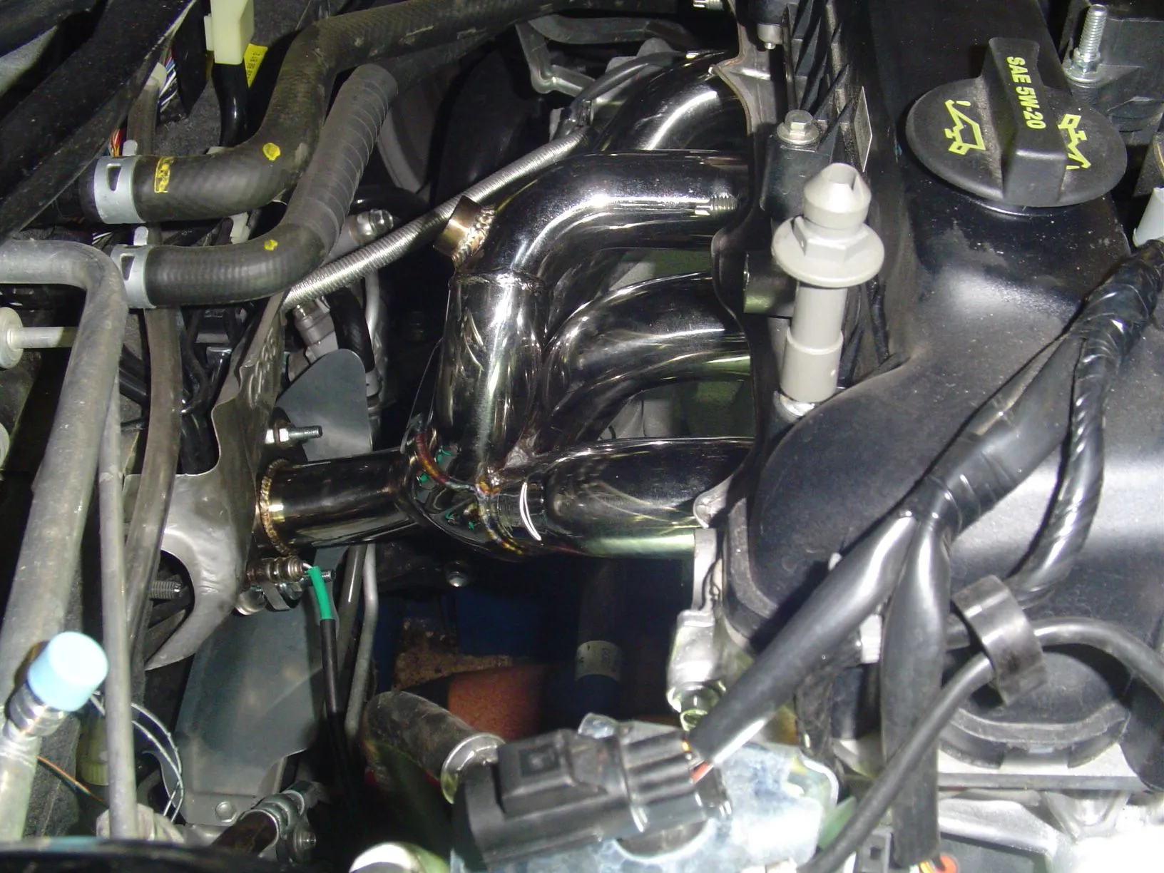

yes, i'm modding the miniminivan :)
they are longer than the obx primaries even at that length if you can believe that!

I assume in that case, that they generate the majority of their power through flow? not actually scavenging? assuming that they are as long as they look (not long at all) you couldn't expect a scavenging wave of any decent strength until up near F1 rpm!

Made for the 5, or procured from the Mazda3? How's the gain?
it is a mazda3 header. gains are very nice up top when you are putting your foot into it. now i need a pulley :D
Yes, it's the Mazda 3 header that I sell. Ken is only the second 5 owner with one.
Ken, lemme know what the code is.
Is there a 4-2-1 in the offing by any chance? 4-1 is better on automatics as I understand it. How doe's it sound bolted up to the factory exhaust, any buzzing or other funky resonances from the differences in tube thickness?
it sounds stock for the most part. if the intake were not on the car you would not be able to tell it was there.

The install on it was fairly easy it took roughly an hour and a half if you do it straight through and don't try to remove the old part as a whole unit.
