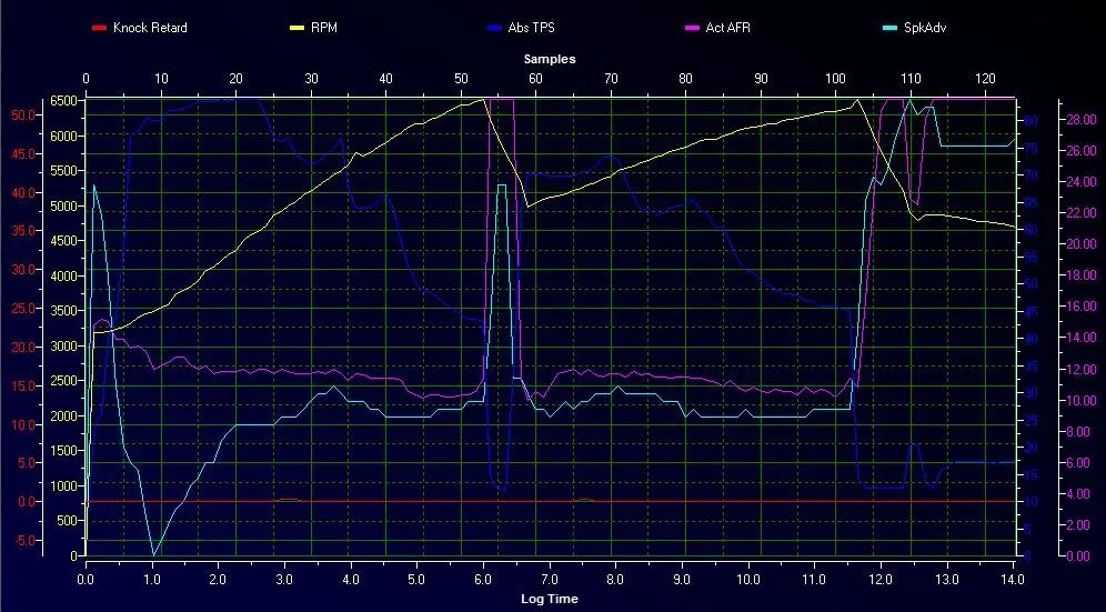

I've spent a fair bit of time getting my afr where I want it using the standback and street tuning. It's spot on at 12:1
Here's my DH log for comparison of the afr.
