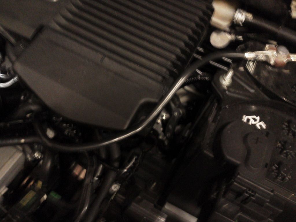

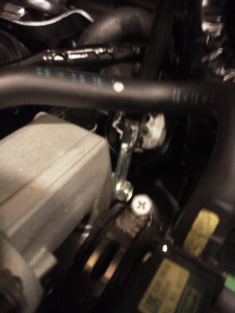

I found a 19" 6 gauge battery cable from autozone for $4.99 and decided to try that before doing the 5 wire full setup. Turns out its the perfect length to go from the upper throttle body bolt to the negative battery terminal, and it already has ring terminal ends on it. I was originally planning on running the ground to the body but the cable wasn't long enough, and I figured this should be just as good.
1. Remove snorkel. The intake side was a takes longer to remove since there's a clip-thing on the bottom as well as the top.
2. With a phillips screwdriver, loosen the two clamps holding on the rubber intake elbow and wiggle the throttle body end out of the way a bit.
3. Remove 10mm bolt from the top/rear of the throttle body. It sits adjacent to the clamp you loosened. Be careful breaking it loose as its fairly soft.
4. Slide one end of the battery cable onto the TB bolt and re-insert it into the TB. Other end goes on the bolt for the neg. battery post. I tightened the bolts down "snug" and certainly did not crank down on them.
5. Re-install rubber elbow and clamps (easier said then done), and then snorkel.
6. Test drive, make sure there's no CEL which might indicate an intake leak if you forgot to put the elbow on correctly.
On my short test drive down the street I didn't really notice anything but how annoying the throttle delay is. I'll check back after some more driving. Pics aren't great due to the cell phone camera.
snorkel was left off for both photos
