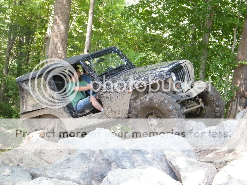

Yeah... I know all too well about making a bad decision that goes against good judgement and common sense just because you WANT it:
... It was a great daily driver before I learned how to weld and went to town(braindead
(whistle)
Each wheel weighs 50lbs, and each tire weighs 100lbs even, and since they're solid axles... the front weighs about 600lbs and rear is around 450lbs... I have THAT much unsprung weight and it can drive pretty well for what it is. Those are 40" tires with 17" beadlocks.
http://www.youtube.com/watch?v=f8CcJmCp-1o&list=UUdHhUnQoZ4TcdhKCo7zwejw&index=2&feature=plcp
So yes... if you can tolerate the wear/tear/ride quality and don't mind the new handling quirks then there is nothing stopping you from doing what you want.

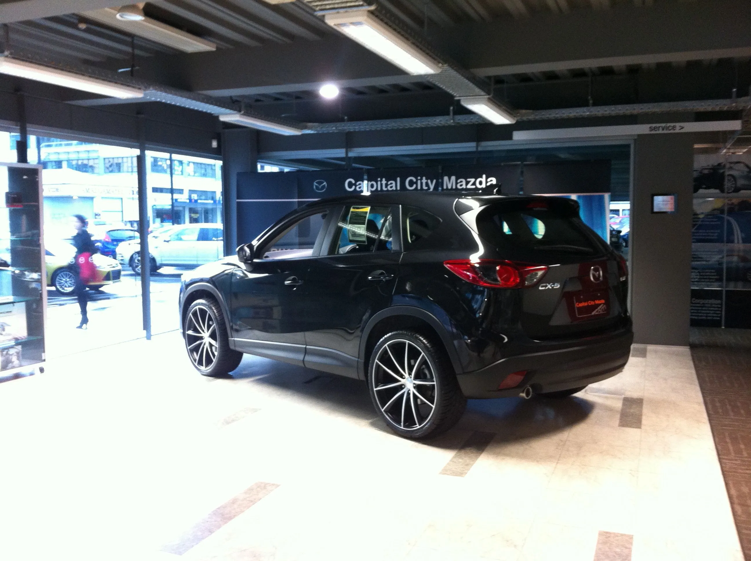

I found something for you Akira Cx5 from Europe 22 x 10 OZ Sardegna wheels
Tire size 265-35-22 Offset +40
Before you decide to buy these wheels, or wheels with similar sizes please read my translation.
The pictures are from the german Mazda site mazda6-forum.info
Die Felgen auf dem Fotos knnen auch nicht auf dem CX-5 gefahren werden,
sie sind zu gro und knnen nicht in den Radkasten einfedern.
Das sind Felgen die auf den CX-7 passen.
Die sind nur zu Showzwecke drauf gemacht worden.
Quote: The wheels in these pictures can not be driven on this CX-5.
They are to big and will not fit in the wheelarches, when pressing in the shock absorbers.
These wheels are fitted for a Mazda CX7.
The wheels where only bolt on for show use during introduction at the dealer in germany.
Check before buying this wheel.
