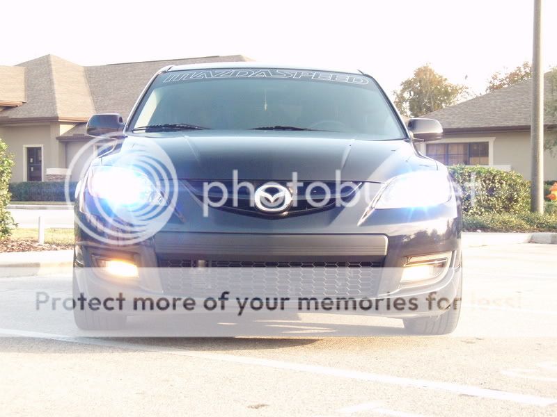

Luminics Yellow Bulbs...
They are very bright and yellow at night...this was at sunset so they don't look that bright. I highly reccomend them...
