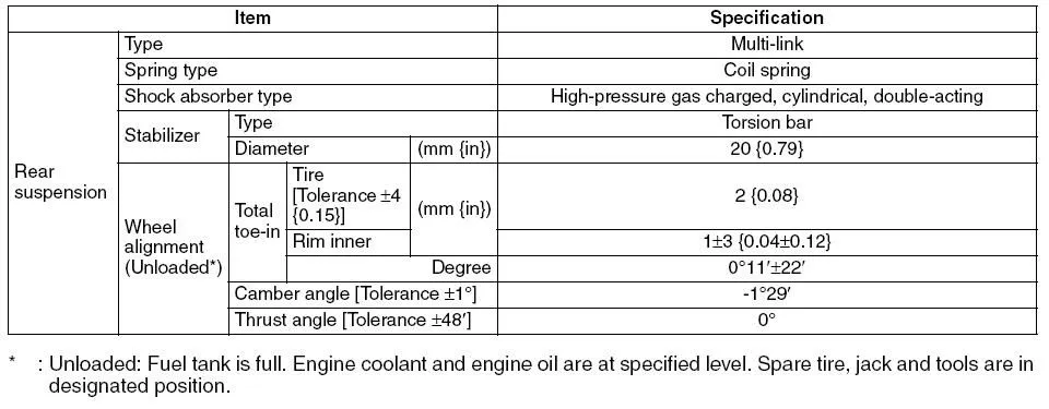

I went and paid for an alignment and they told me it was minor adjustments that they had to make. I think I will take some of the advice from 7red7 and see how it goes.

Well the place I took it to to get the alignment did not have a way to adjust the camber the way it needed to be adjusted. I need to go to Mazda and find out what exactly they find.
I will double check the tire pressures and try increasing it, but while it may alleviate some of the wear, it is still not going to fix the problem that my rear right wheel is leaning massively.
well I was under my car tonight removing the bike rack (I removed the rack with the bikes still attached) and I noticed something. The pivot bolts for the lower control arm have off-center washers with degree markings. So from what I can see, camber adjustment is acheived by adjusting these. Not on the upper control arm as per usual. On mine, the indicator is just a hair outboard of what looks like 0 degrees. I can take a pic if it helps
Yes, they're eccentrics. What I haven't looked at (perhaps you have?) is whether that will adjust the camber or only the toe. Is that lower link the only piece for the rear suspension, or is that the rear portion of an A-arm and there's a front arm as well? If it's the former, it should adjust camber. If it's the latter it'll only adjust toe. If there is a front arm as well and it also has eccentrics in it, then you can adjust both simultaneously and get a camber adjustment.
There is no camber adjustment on the 5.
Those excentric bolts only adjust the toe-in.
A very poor design

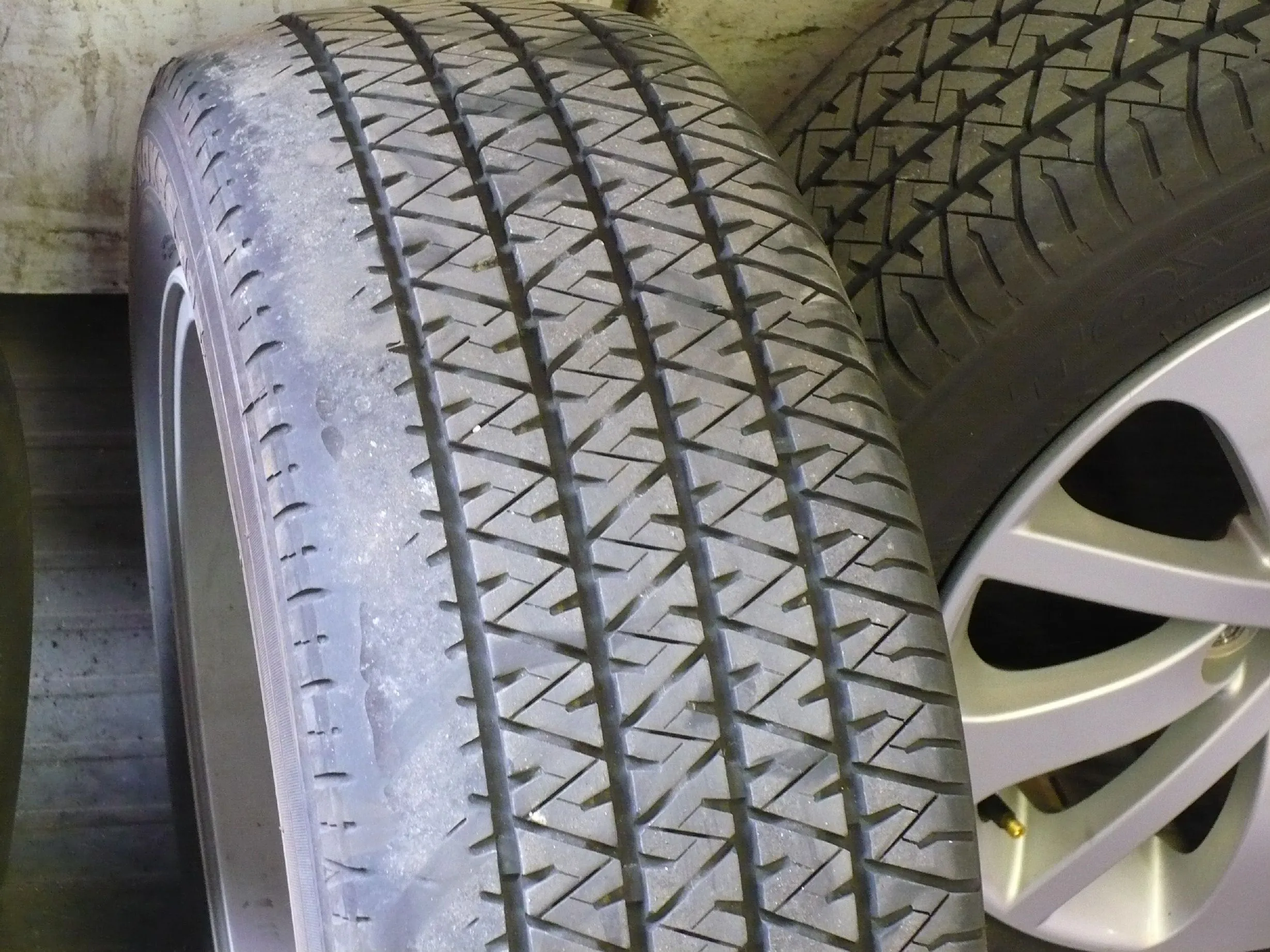

Well I can add to this forum. I did change mine over the winter and spring ( Toyos to snows etc) and thought that should be good.. well it wasnt. The Mazda dealer today gave me a fix and this will allow a little adjustment to the camber.It will allow a little more positive camber, by replacing the camber adj bolt with the bolt pictured.. I took the car to an alignment shop and they adjusted the camber AND toe..
Meanwhile I bought a decent used set of Yokohama Avid TRZ's.
