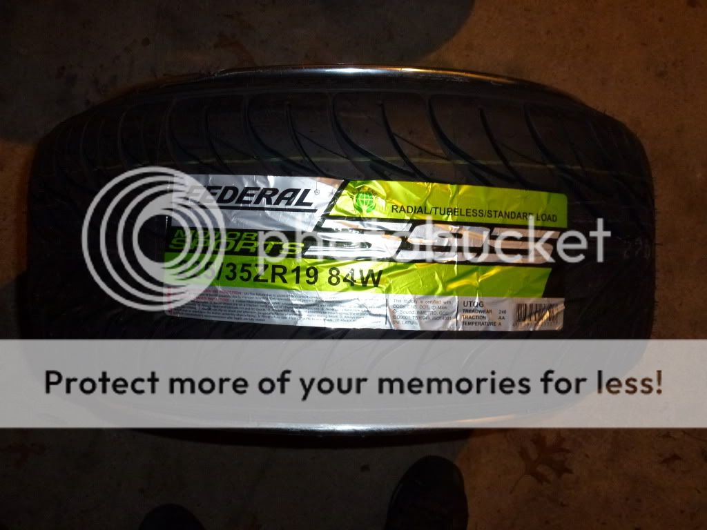

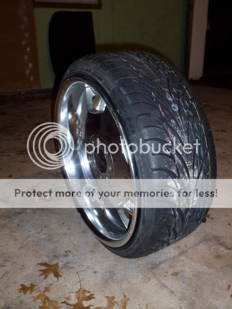

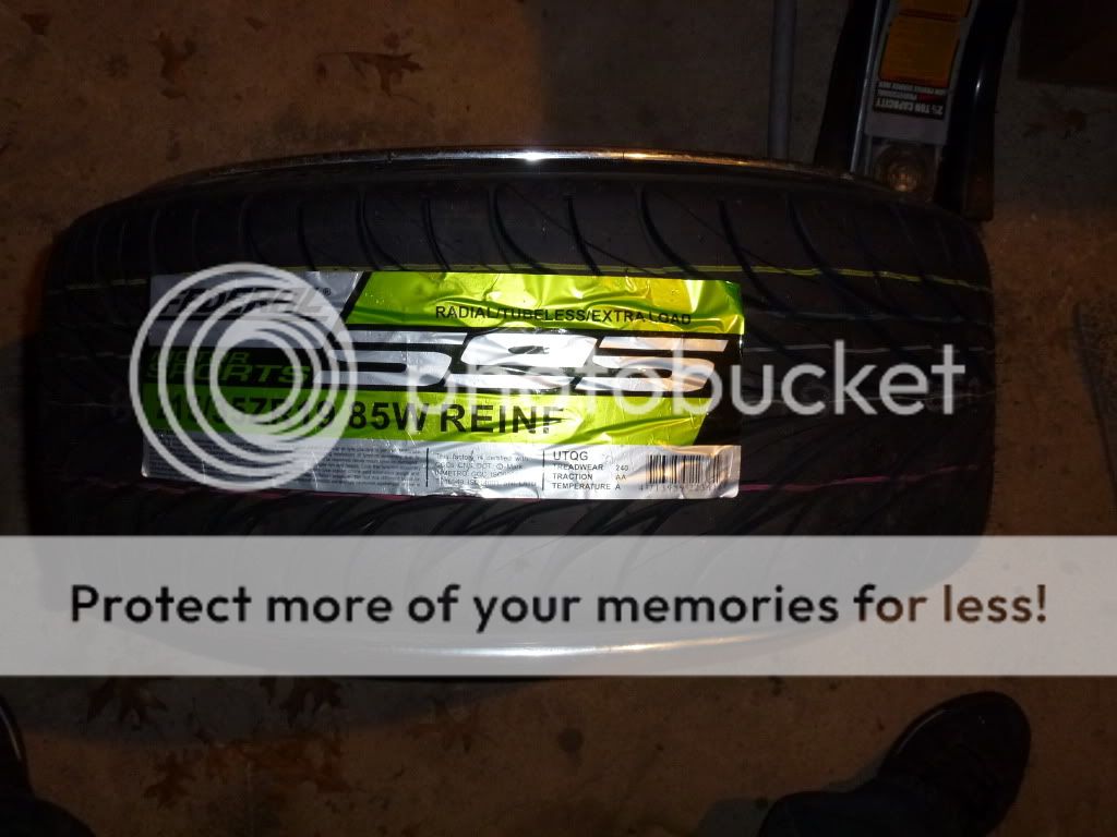

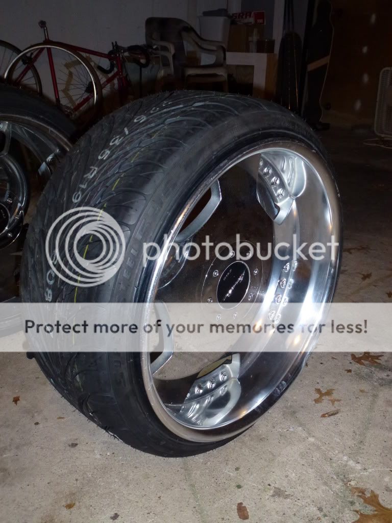

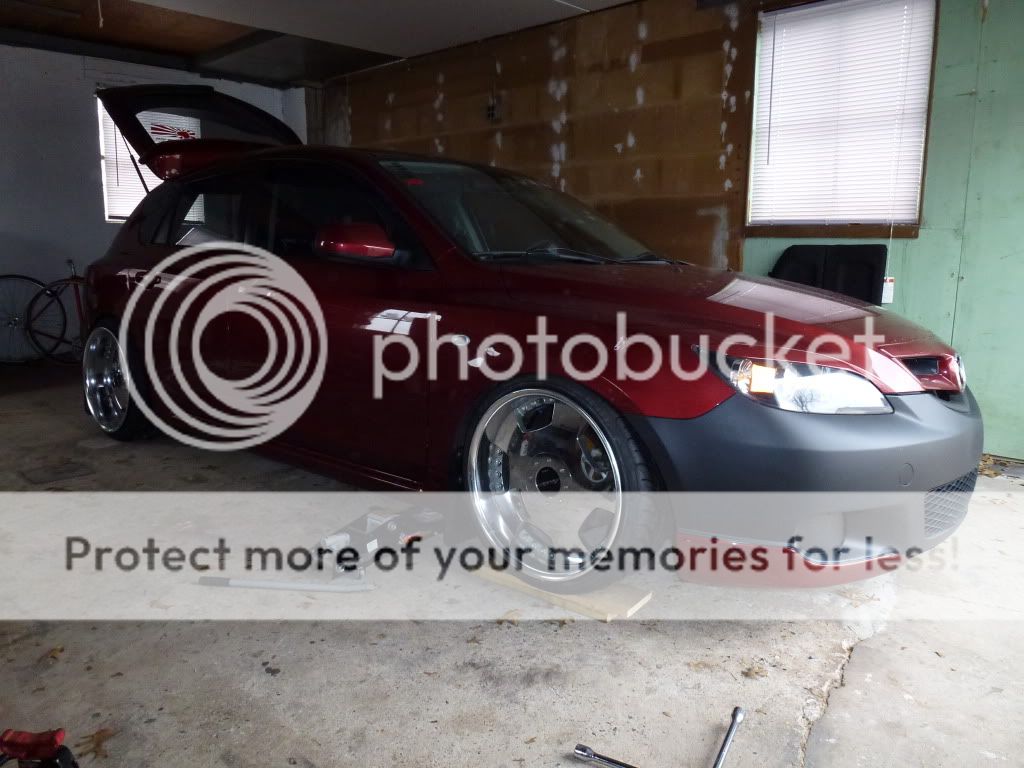

Rims are in
19x9 +30 front and 19x10 +32 rear.
Test fitted them this morning.

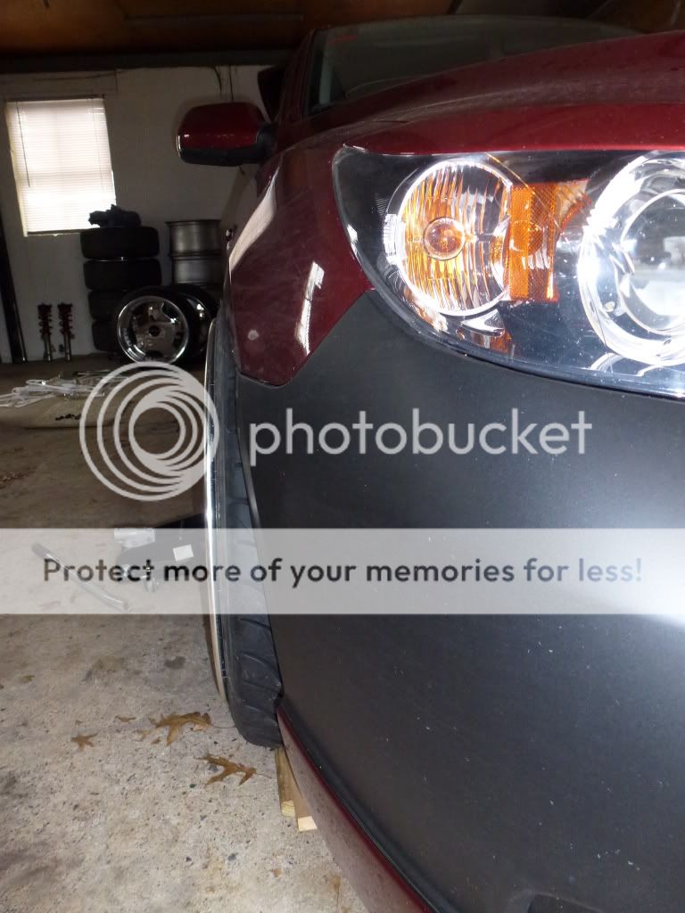

The fronts should be fine once I get some camber dialed in. Fitment is CLOSE to the strut and spring. Maybe a half a finger or so of clearance. I wasn't able to get any pictures.

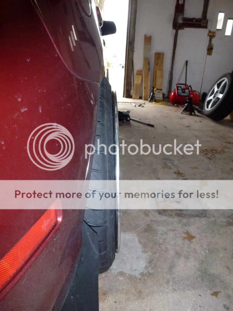

The rears are going to be interesting. There is 1 1/2 to 2 fingers of clearance from the strut. I am sure I can pull them in far enough it it just a matter of whether I will need to space the wheel or not. The rear was not settled in this picture because I had the front wheel up on 2x4s for jack clearance. My last 19" setup tucked half the sidewall with the same sized tires and camber.
I am hoping to dial in the fitment next weekend.
