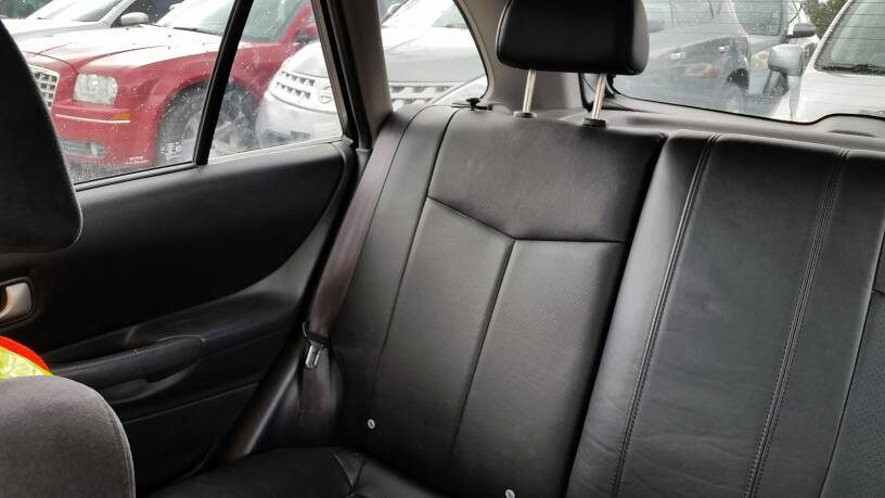

All the interior door panels of the car + rear bench seats are now leather

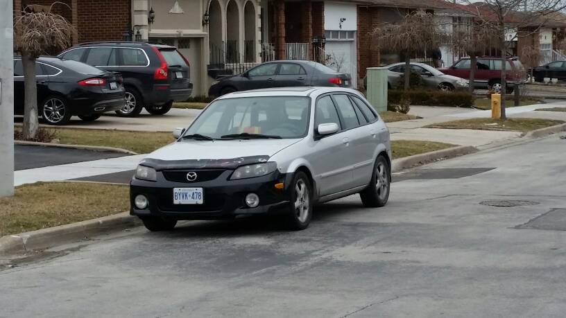

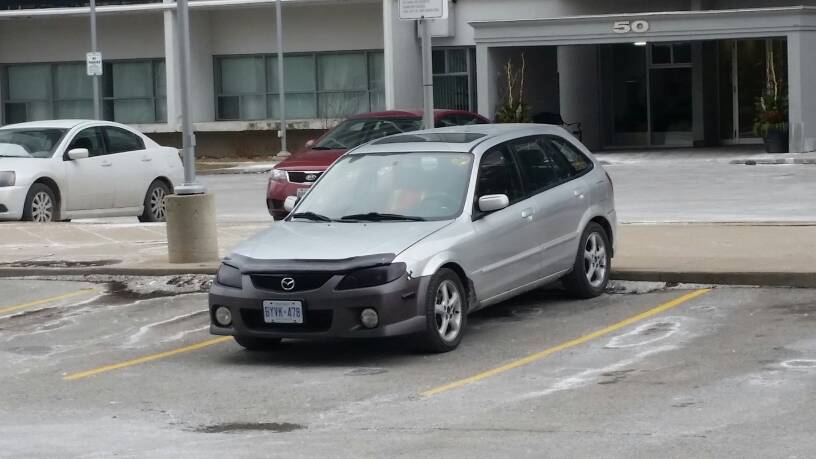

- So I have M6 wheels with rubbers 205 50r17 for the front and 215 50r17 for the rears .
With a test fit in the rear on stock shocks + springs it clears height wise by mm's but is making contact the the shock tube on the inside
- Will 10 - 15mm spacers in the rear make it happen?

215 50r17 might rub a little, I have an 03 p5, have 205 50r16s on it, dropped it 2" an I rub on big bumps, I got a cheap set of springs and cut them tho, I kno I kno, I did it right tho lol, if u plan on leaving the stock setup the way it is u should be OK

Turns out 215's touched the shock tube on the inside so now I have 25mm h&r spacers only in the rear

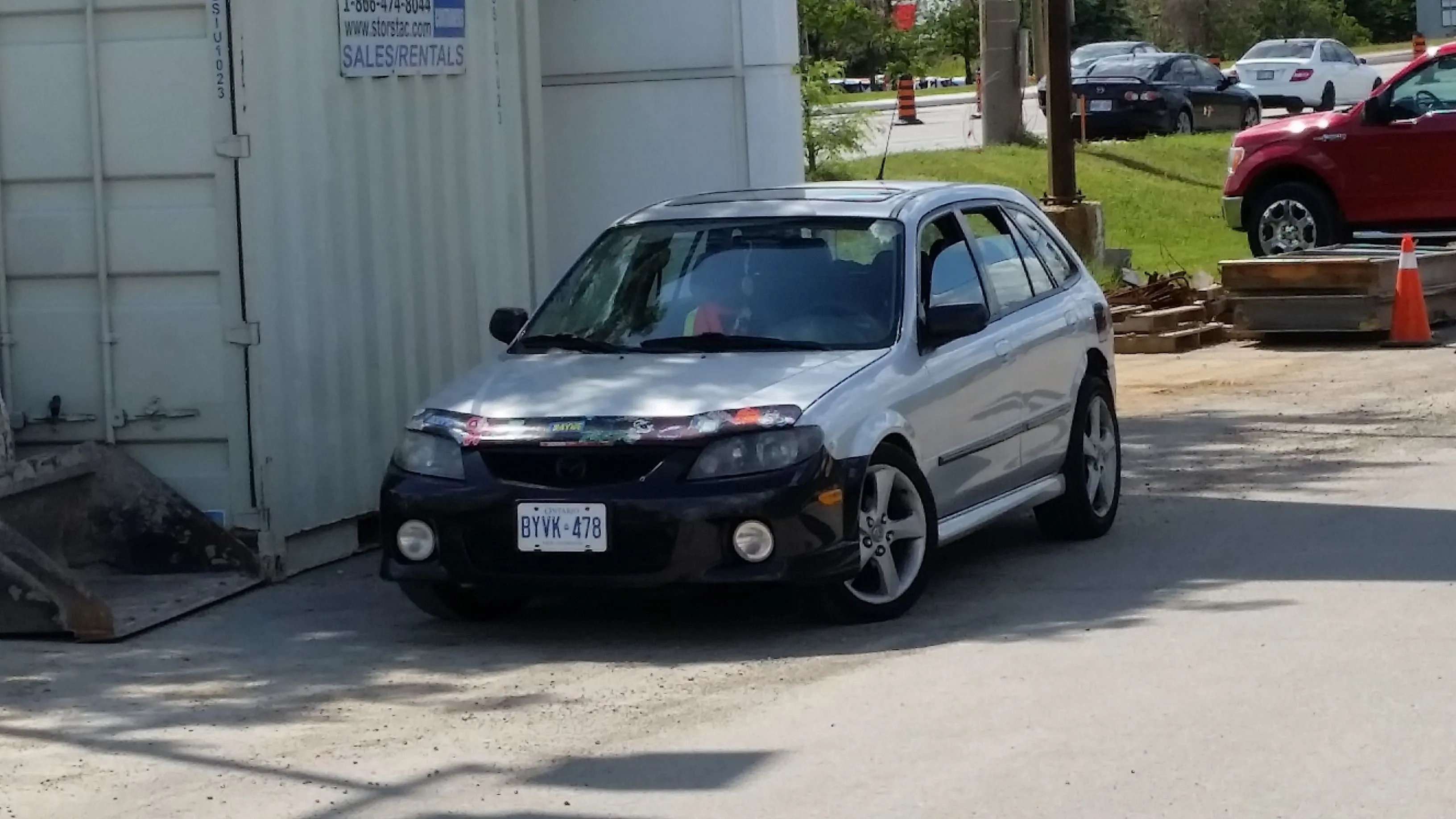

It looks good, I took the bump guards off the sides of mine, and it looks like u had the famous rust out on the back quarters, I had to do mine as well, I fixed it with bondo the first time, think I'm going to just weld a new one on there just for longevity, I don't have the sun roof, although I may drop one in one of these days idk, I just did a/c and p/s delete, depowered the stock rack and love it, anyway, looking good, I'll be back to check out progress

Piece by piece bud 😊
That's it lol, piece by piece or will all come together, here's mine, looks a little off right now, it's being painted, wet sanding today...
