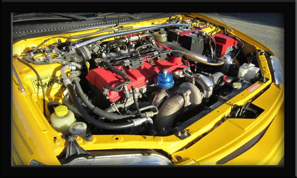

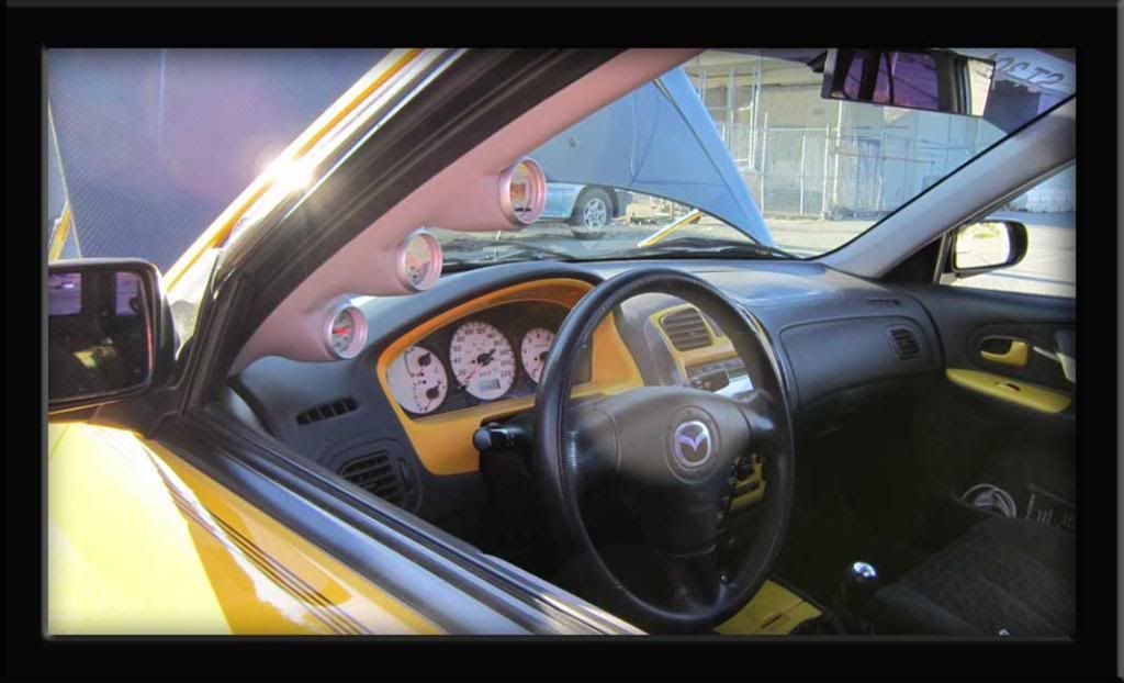

The Progression of my V.1 Street Sleeper Turbo build
Took some pics today...

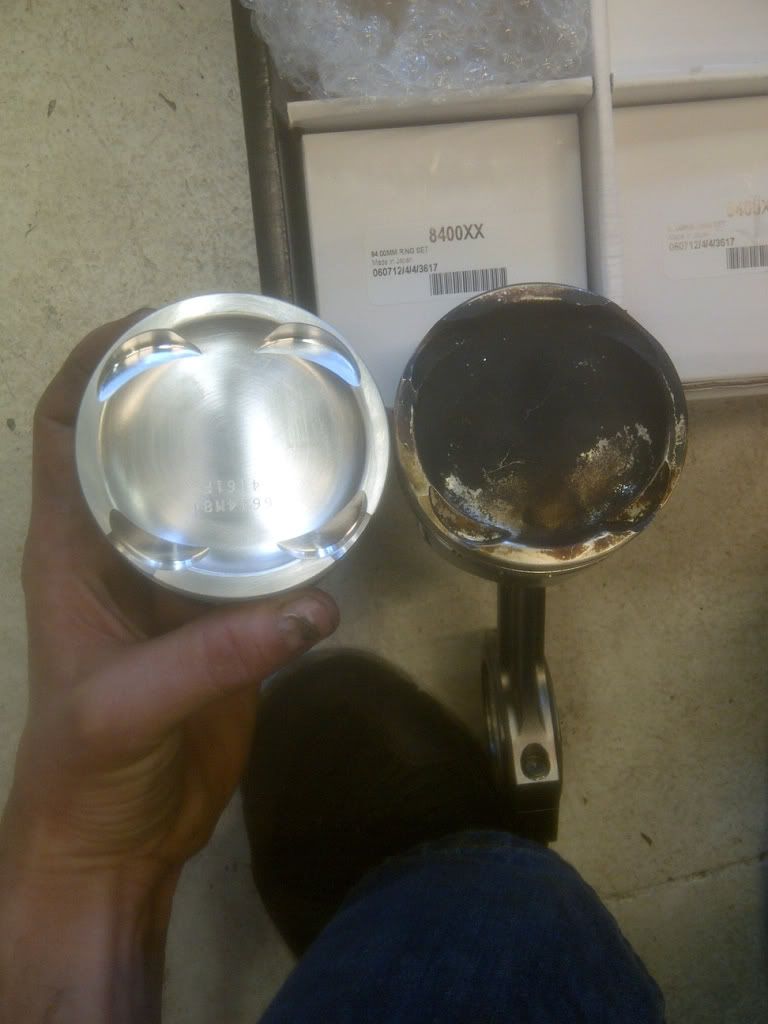

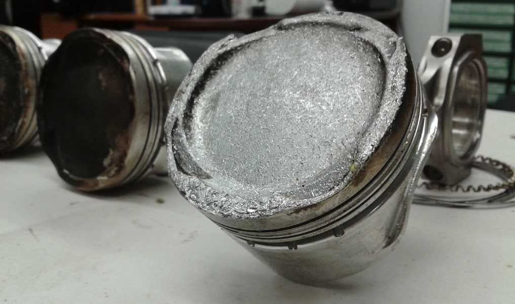

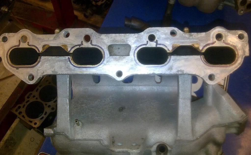

ARIAS pistons blow! 2nd time broken at the ringland. Wiseco .040 going in next.
I had FOUR ******* SETS of those garbage pistons all lose a chunk just like your first one - right in the valve relief. Went with CP and never looked back.

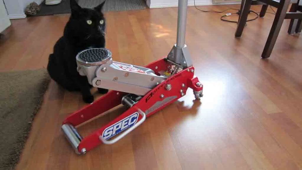

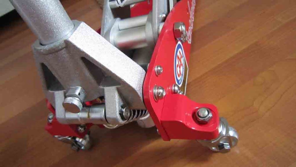

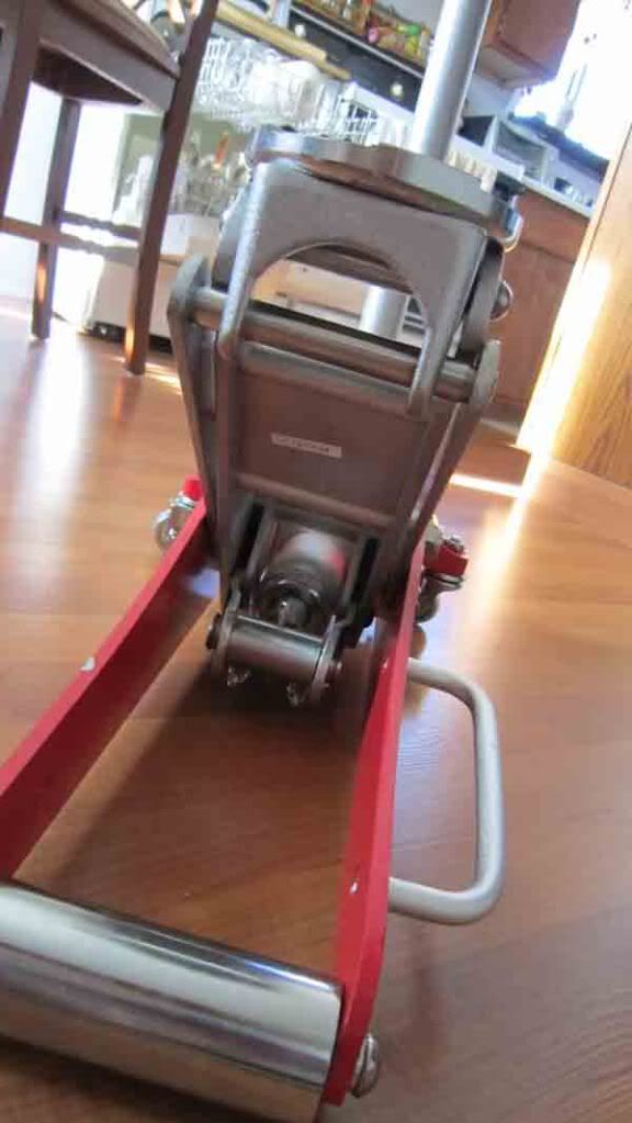

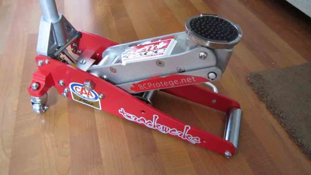

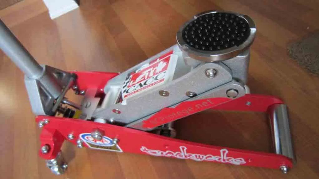

Bought something today... 1/2 price @ Cambodian Tire! :D
Ya I had a few stickers laying around... lol

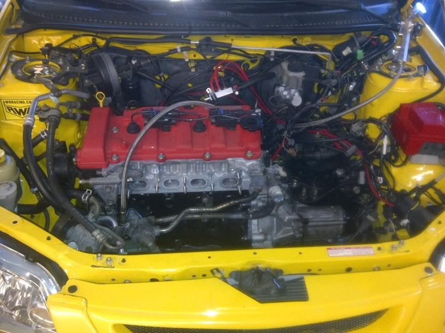

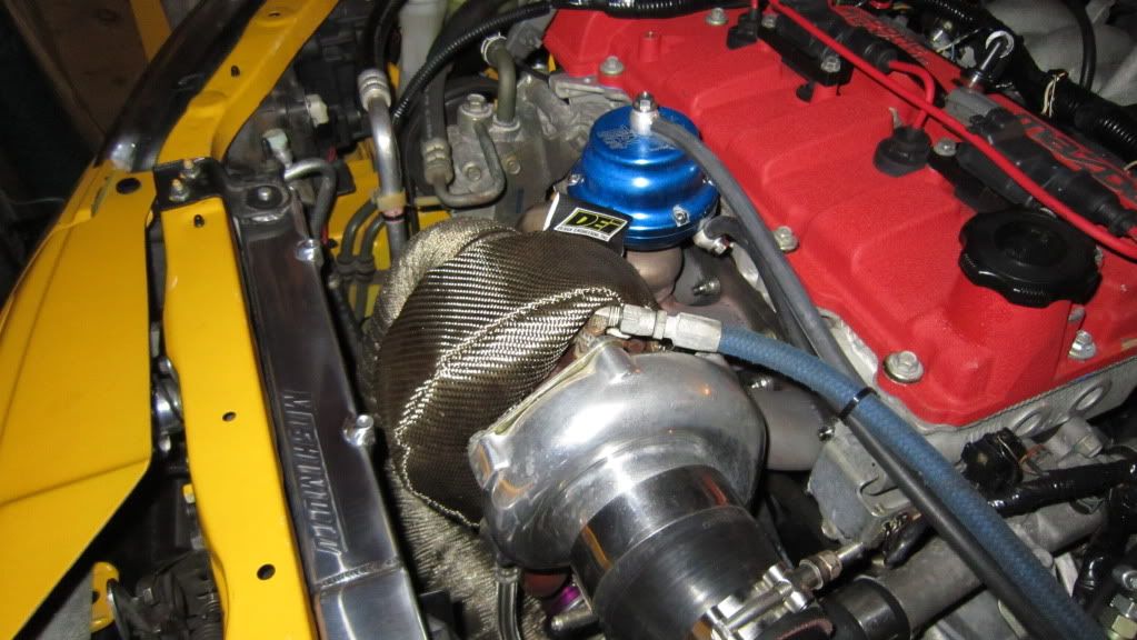

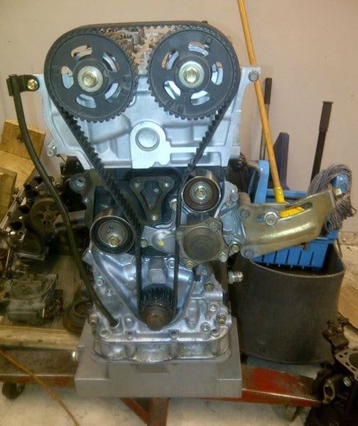

New engine is in, new PAR/M-factory trans is in.
Went for a little hwy cruise yesterday. These PAR/Tri-Point gears are sweeeeet! Takes some getting used to the noise tho'.

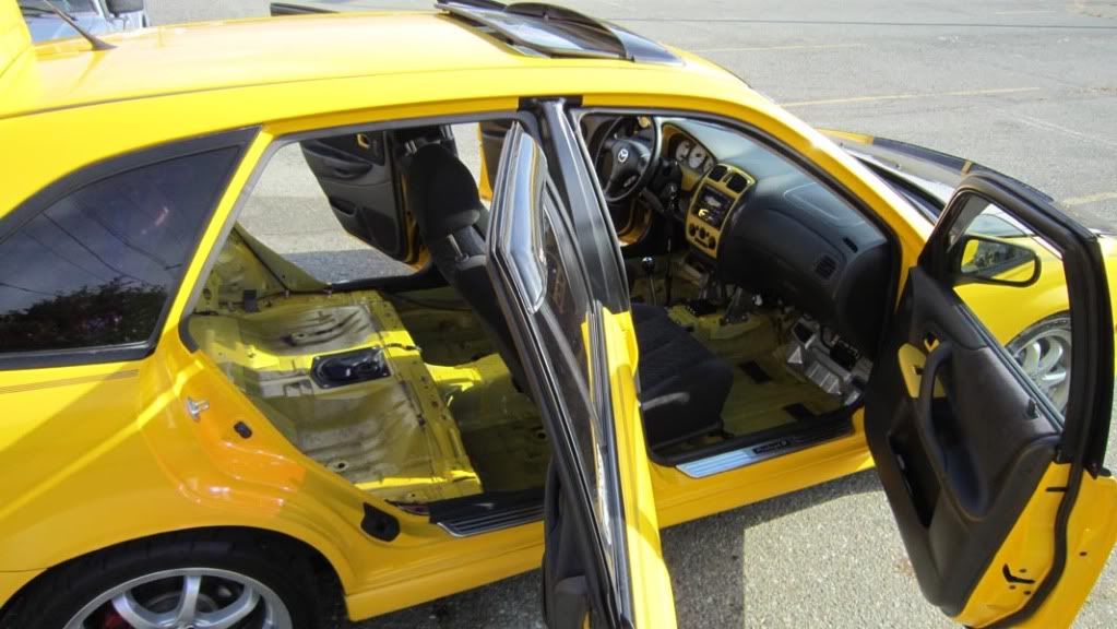

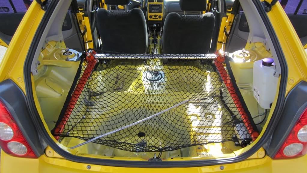

I decided to add some more lightness to the car today. Then I loaded ALL of the interior stuff that I had removed and had stored in my spare room along with todays donations and took them to the landfill. Total weight? A staggering 70 kgs!!! I couldn't believe it!

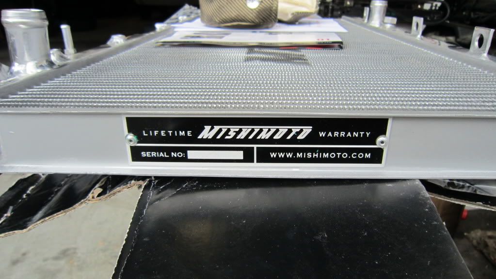

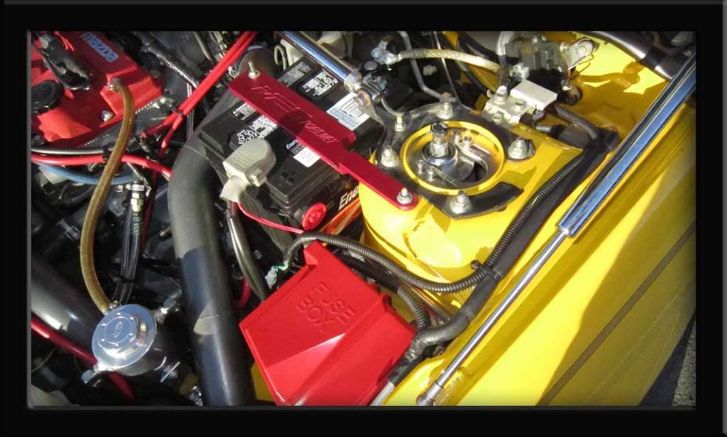

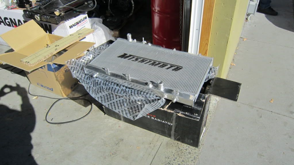

Busy day today. Went back to the shop to install a few new goodies...

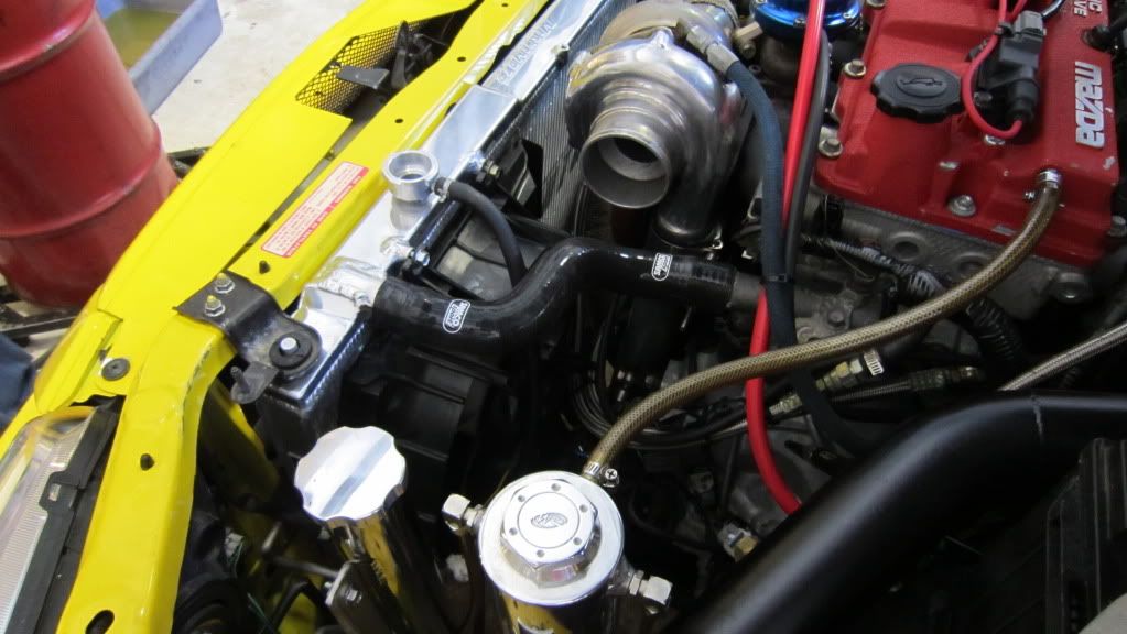

Mishimoto Rad
Samco Hoses
WOT Box
Turbo Bag

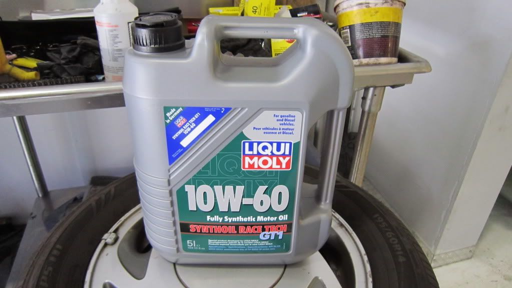

and the 1000km oil change...
So with the pistons that were damaged due to just fuel cut by our friendly dark ages microtech, can you tell me how continuing ignition with no fuel would do that?
