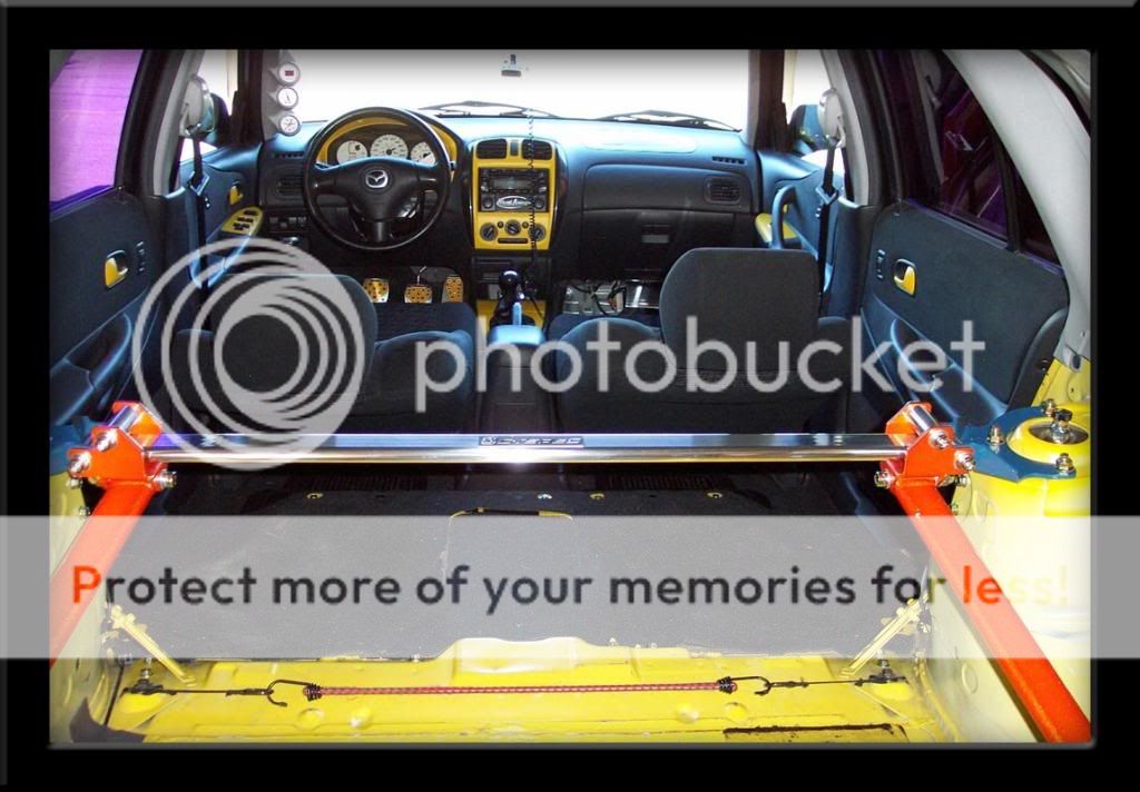

Trunk cage is in.

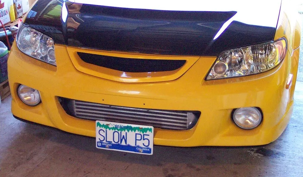

Got new plates! Had to rig up a custom front mount.
