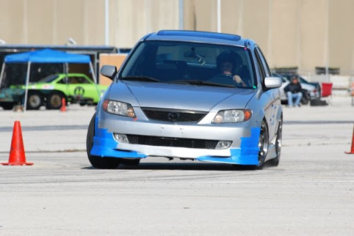

here are a couple of my autocrossing pictures that will show you the difference between suspension set ups and camber. in both pictures i am running the same camber . 2.5ish in the front and 2.0 in the rear.
in this first picture i am running akmost blown stock monroe struts with tein s tech springs.
in this picture i am running stagg struts and teins in the front and blues with rbs in the rear. you can see there is less roll and the wheels have therefore rolled less and remained flatter. it will even be flatter with the msp front sway.
