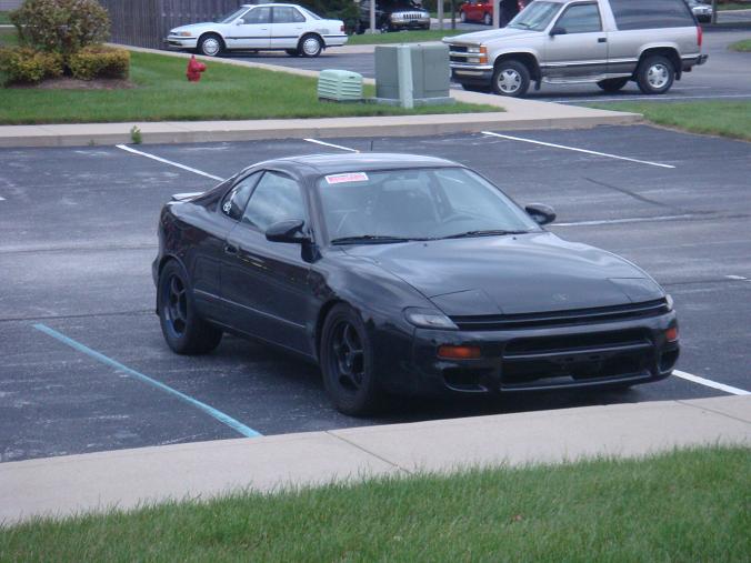

well i guess ill give it a go
before..
dont mind the stickies, gf thought it would be funny to cover my car in them for my birthday last year..
and now..
lowered on ground controls with the front spring perches cut off.
