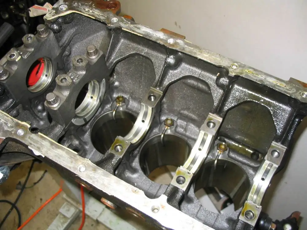

So back to this welding in a nickel rod to help stop crank walk... It obviously can't be between the mains themselves as the crank is passing through there. So are you welding on the upper oil pan somehow between the bolt points? Are you going in the direction of the crank (cylinder array oriented) or are you going perpendicular/with the journal (which would do little for lateral improvements). This seems like it would be a reasonable affordable and simple thing to do, just a matter of knowing what to do. I'll definitely throw it on my "list" of things to do during the build of the block.

Here is a pic of the upper oil pan/main bearing support plate. The blue lines are about where I'm assuming you are planning to put those nickel rods in???

actually that part is aluminum, so its not the part we're talking about. .. its kinda hard to describe, but if someone has a picture of an FS flipped upside down with no crank in I could point it out. its actually above the crank, I'll just have to show you.

Hence my confusion as to how this was being done :). I have pictures of the engine upside down without the crank... so I'll post that soon... but gotta run for a minute.

EDIT: Picture attached now.

ok, red arrow indicates how the crank walk is probably occuring. the yellow box is one area to weld up, making thicker to combat this (for all 3 ribs), and the blue arrow points to up under the ribs to a large area that can be welded onto to make thicker, or even gusseted.
I believe if you can strengthen the ribs you can combat the crank moving laterally due to flexing of the block
