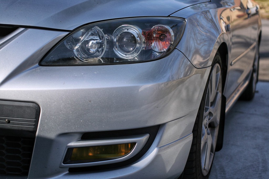

Also fixed my fog lights. Installed bulbs since they were just missing from when I got the car and rewired in pigtails.

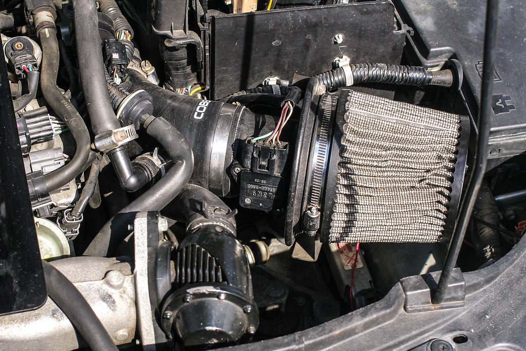

Finally replaced the intake on the car. The moment I laid eyes on the filter, I wanted to get rid of it but the HKS short ram piping only allowed for HKS pod filters or cheapo compact filters. I want to thank Damian again for donating me a Cobb short air intake! Removing the old intake, I discovered the intake filter had actually fallen apart and let in a lot of dirt #muchdisappointment. Cleaned the MAF for good measure. Made a custom bracket to secure the intake to prevent it from wobbling.

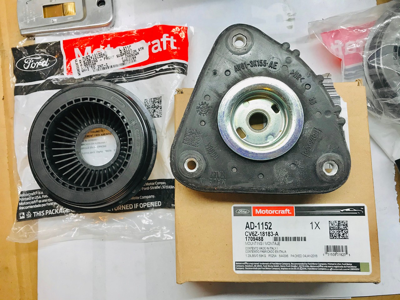

Washed my wheels yesterday and rinsed the pollen off the car. Finally got notice that my strut mount and bearings shipped yesterday, almost a month later.
Strut mounts and bearings are in. Now to clean the garage floor so I can have room to work on it.
