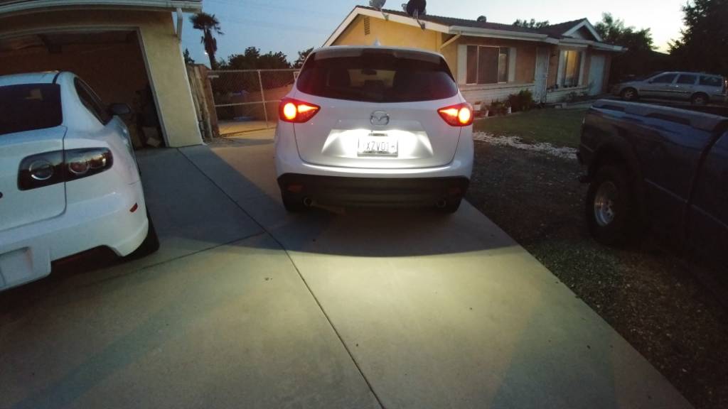

Love the new 5730 t10 leds. Mind you look how much lights hitting the ground. $10 better than the $20 phillips I installed on my 3

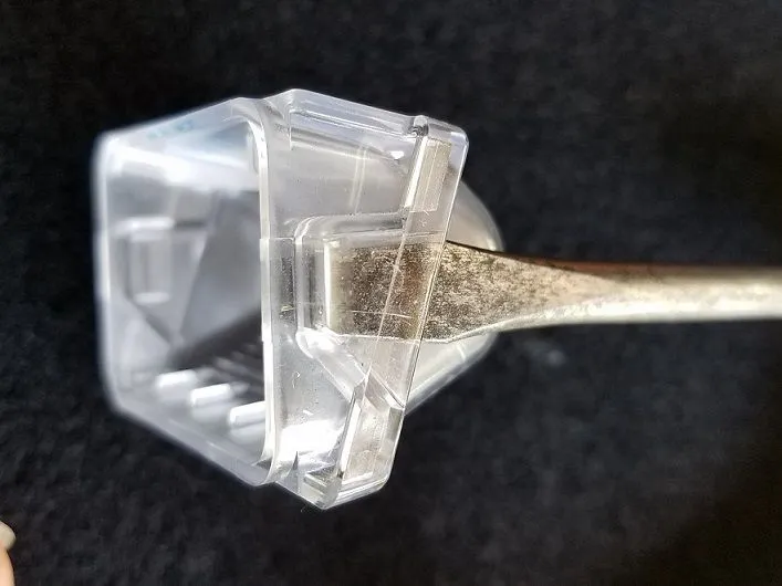

I too, had a go at getting the lenses for the license plate lights off. My '15 had a pliable translucent lens which would easily pop off. The '17 uses a rigid clear plastic lens which doesn't seem to budge when prying it with a flat bladed screwdriver without fear of cracking the lens. I've studied the drawing in the manual but it's little help. Can't easily see how those black plastic ears inside the slot engage the clear plastic. Shaped like a V.
Someone smarter than me is going to have to figure it out.
EDIT: Issue resolved. Please see this post

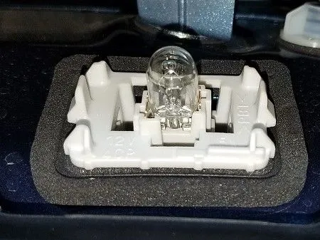

Ok, mystery solved. For the 2nd gen CX-5, the trick is to use a wide enough flat blade screwdriver - I used one with a 9/32" wide tip. Insert it into the slot on either side of the clear plastic housing and adjust the vertical angle until it's seated fully into the socket. Gently pry toward the center so that the blade expands the base away and it should let go.
attachment.php
Notice the base has 2 retaining posts with a significant wedge-shaped key. I guess Mazda wanted to make sure they wouldn't fall off on their own.

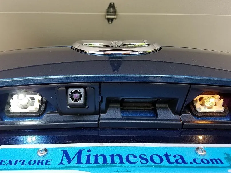

I took a comparison shot with the stock W5W bulb against a VLEDS 194 6K bulb which I believe is this one.

I had retrofitted my 2015 with RED VLEDS 194 bulbs on the rear side marker and the small rear light on the cargo door and I'm sure these LEDs were a bit brighter and more saturated ruby red than the stock Mazda LED tail lights on the 2017. It may be that my license plate bulbs might be a bit too bright and overwhelm the factory red LED combo tail/stop lights. If so, then I may look at getting the longer life (and a bit dimmer) 194 bulbs from VLEDS.
IMPORTANT! When installing LED bulbs, be sure to TEST it before reassembling everything. If the bulb does not light, reinsert it the other way and it should work.

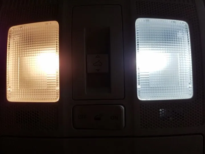

Once again, I replaced the stock interior festoon bulbs (left) with VLEDs 31mm 5K Long Life #3175 LEDs (right) which are being discontinued and offered at 50% off the list price. You need 5 bulbs - a pair for the front seats, a pair for the rear seats and a bulb for the rear cargo compartment. The factory festoons are 29mm but 31mm festoons fit just fine and you get more choices.

I originally had the high power 6K LEDs in my 2015 but with a black interior, the effect was a little too cold. The 5K bulbs match up with the DRLs, etc.
