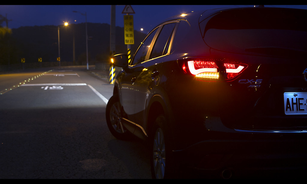

Tail Lights Installed
As promised earlier, here are the pictures of the new LED tail lights installed...
Lights off:
Parking lights on:
Hazards on:
Lights off:
Looks good. Mine CX5 is white too but the led tails are red/clear without the smoke. My last car was blacked out, tinted tails, sidemarkets, etc. and I got tired of it so switched it up for the CX-5. Thanks for the heads up on the brake light tap in. I'll try it when the warm weather comes.
