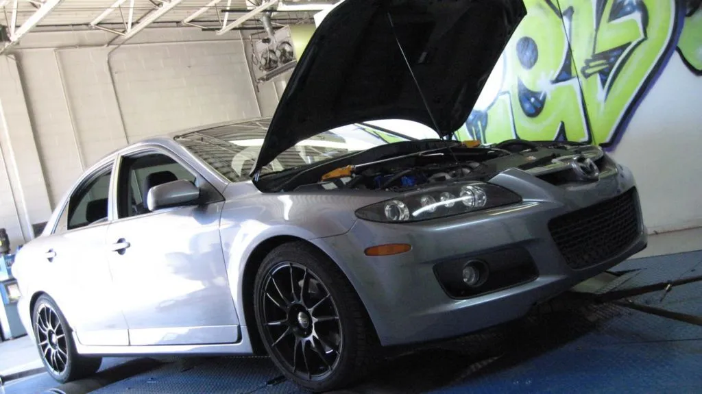

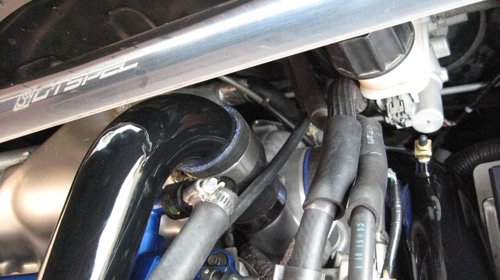

Hey there. I haven't heard of this technique. I will look into it. Right now I have the boost pretty much stabalized at 20 psi after adjusting the aem tru boost gauges spr settings and the boost duty cycle on this solenoid. What I do find happens is boost cut around 5500 on full boost is taking place. I can't use the standback's boost clip settings because I dont think this adjustment works if you are not running the factory wastegate solenoid which I am not. I don't know if I should end up using a map clamp or not. I was going to run a custom manifold with external gate but the manifold is on backorder and I would just rather keep things simple at this point, especially since I have the boost ramping up to 20psi quickly and holding. I do have the 7psi spring in it now, which fully opens the flapper at 20psi using a regulator. Currently the car is partially tuned but I think the tuner is afraid to run some well deserved boost on this car. I want 24-25 psi on this turbo all the way to 6500. I am getting the cp-e full control reflash next week, so the throttle plate will be right as it should along with some other improvements. I am willing to drive my car out of state for some tuning. Please give me some recommendations if you don't mind. I have almost 5000 miles on this new engine and everything is tip top. Modified the factory exhaust manifold heat shield yesterday so it would fit with the gt3071. It dropped my engine bay temps by 40 degrees f. I am also getting excellent gas mileage. Went to cedar point today and was able to get 312 miles with a quarter tank left. I will get about 410-420 miles until she is empty. I made sure to stay in vacuum the entire time driving. I was impressed considering i'm running super rich and have the bigger CDFP, not to mention a gt3071. Talk to you guys soon. Here are some pics I took today:

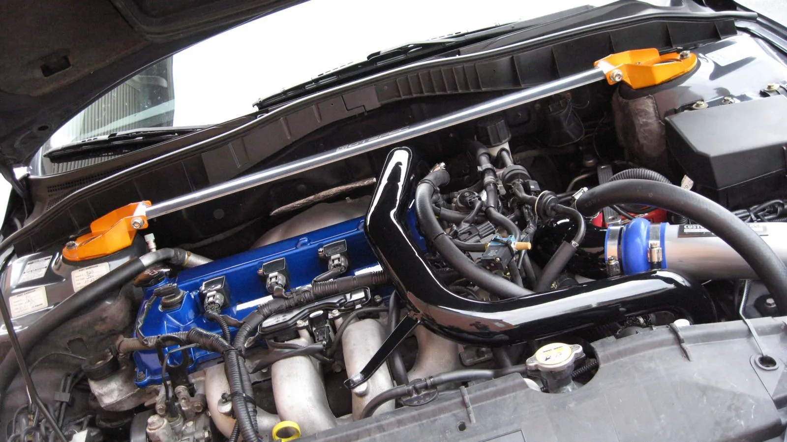

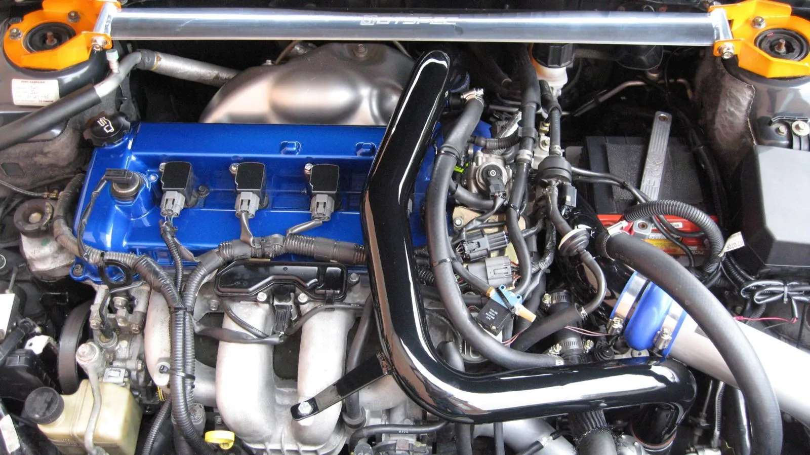

The car is still running strong. Over 8000 miles on this engine. Car was on the dyno for a bit. ATP turbos absolutely induce boost creep on their internal gate design. After adjusting the aem truboost, I was able to pull 290hp 290 ft/lbs on 19 psi at 5250 rpm because I hit a boost cut. This dyno has stock STI's at 215-220 hp. I now have a protege garage equal length manifold and an external tial 38mm wastegate that is in the works and should be installed next week. I also have a split sec electronic map clamp which takes care of most boost cuts. I also just installed the HKS twin power ignition yesterday and I must say, I can't believe I didn't purchase this sooner. It's a world of difference. Faster spool, smoother acceleration, more power up top, worth every penny. I am very confident the car will spin 340-360 on the mustang, at 24-25 psi based on my current pulls and I will be very content with this. At the crank it should yield 430-440hp. I also picked up a gizzmo shift light and 2-step which should help at the track. I'm almost done with this car. My goal is to get this car to make an 11.8 or lower pass. This will then become a Mazdaspeed GTR.

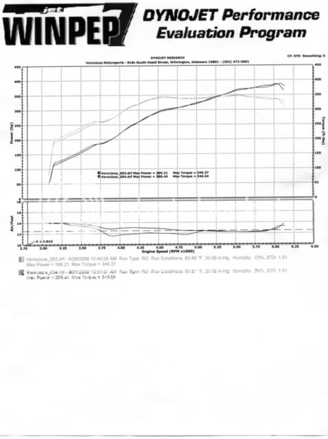

whoosh dyno'd 382hp (somewhere around that) on stock block in his speed6. Unless I'm completely misinformed.
whoosh did back to back 386awhp/349awtq pulls at Verocious Motorsports in Delaware on the completely stock block and head on 8/28/08 @ 10am
that's with no tuner but he (I) have the cp-e throttle plate flash:cool:

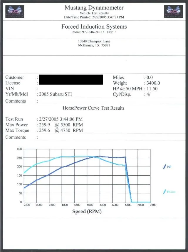

The dynojet will read 50hp higher than this dyno. Look at this bone stock STI for example in this picture on a dynojet. I have a evo dyno I can post as well on the very same dyno I am on which spun 360hp/376tq and he is consistently tracking low 11's. All I can say is the track does not lie.

OK so 386 minus 50 as you say is still 336awhp on the stock engine/head with no tune vs. your fully built and tuned 290>>>still significantly higher
