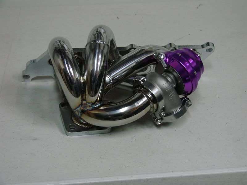

Apparently, seems like the issue is w/ the 28R and 30R. The wastegate housing is too small for bleeding boost fast enough. That is why we have creep issues. Also, my DNP Tubular manifold and the CP-E flash may also contribute to this. Externally wastegating this setup is probably the best way to resolve this creep issue. I would go w/ a 44mm instead of a 38mm though.
Seems like w/ the 35R, whoosh does not have creep issues but again, im not 100% sure how the wastegate on the 35r is designed. i sure as hell have bad boost creep.
Currentlt running on a 15lbs wastegate spring but with the mods in my sig, on a cool day I will see 23lbs easy. Very scary and dangerous imo. That is why my car is untunable as of now and running on a zeroed out map on the standback. Skyline is headed in the right direction w/ the external wastegate.

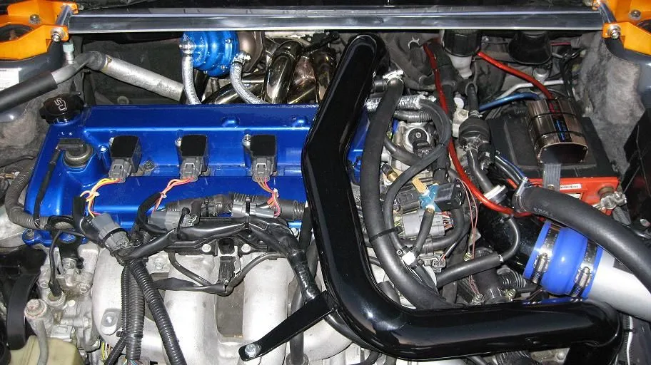

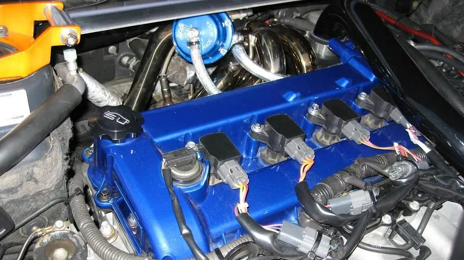

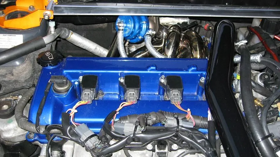

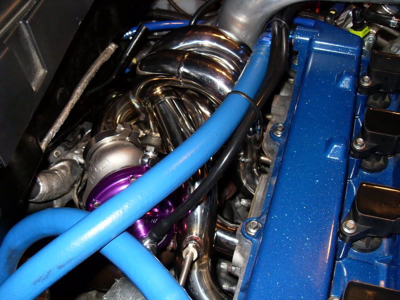

Like my man Ice Cube said, "Today was a good day!" CHECK OUT THE EXTERNAL GATE :)
Getting on the dyno on thursday with the external gate setup. Ordered an atv fmf 1.5" muffler for the dump tube on the external gate. They sound wicked. I will also do a quarter mile run on the dyno and take her to the track on saturday hopefully for comparison. The dyno has only a tenth of a second variance to the street. Also, for anyone running bigger turbo's on their speed, consider the hks 2 step colder plugs, 8's. They have brought my egt's down and the engine seems alot smoother under hard acceleration.
