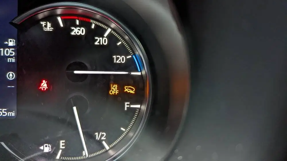

I have the "TRACTION CONTROL SYSTEM" Icon.
??? Are you talking about this indicator light in your instrument cluster?

Unless I'm misunderstanding the discussion (always a possibility), my 2020 Signature has both. Pressing each produces the following.
Oh, and as many times as I read it I still can't figure out which does what? - At my own risk I want to accelerate and corner like a mad man in the rain. Sadly no snow in PHX tp play in.
View attachment 304828View attachment 304829
The switch showing a car on a bumpy incline is for switching on Off Road Assist. The one with a car veering out of it's lane is for turning off lane keeping / lane departure. The dash indicates off road is on, lane stuff is off. I can't tell what the lower left switch has printed on it. Is that a silicone button stuck on there?
