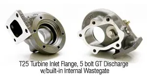

The T25 turbine housing (which is the exhaust side of the turbocharger) should look like the attached picture. Housings are sometimes interchangable too. But I believe the picture is the standard format.
The MSP turbo is a T25. That I know. The callaway manifold has a rectangular, four-bolt plate.
Without seeing a T25 from a DSM, I wouldn't be able to tell you much.
