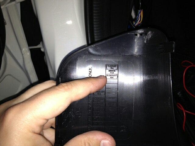

I used the First open slot in the second column- the one nearest the dead pedal
I think it's slot 11. Manual said rear power. No fuse. Nothing is in it but it has power And is switched. I used it to hook up DVD players.
Here is a pic from a referred post.
