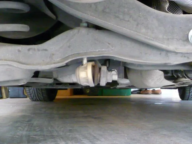

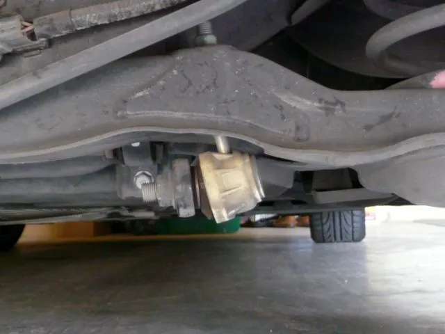

I was feeling some vibration in the rear end (of my car - gotta head you guys off). I figured a tire was out of balance. I am getting uneven wear on the inside of the right tire. Got home and took a look at the rear suspension. Something looks amiss... See the attached photos of the right and left sides. Does that look like a bent stabilizer control link to you guys?

Finally... left and right shown below. Does that look normal?

Looks like your Rear sway Bar shifted to the right. Try loosening it and seeing if it'll go back centered and tighten it down.
That shouldn't happen.
edit: under reexamination, it appears your right sway bar end link is actually bent.
I think you're right, but it looks to me like the sway bar itself is also bent. Shouldn't the ends be vertical?
So I have to replace this stuff, should I go aftermarket? I'm sure OEM would probably cost even more... Opinions welcome.
I don't autocross or drive excessively hard, so I'm not even sure how this got messed up.
Agree that the right end link looks bent. I'd get under there & do a close inspection of the bar, bushings, links, etc. to make sure there wasn't some sort of domino effect damaging multiple parts.
If you are under warranty, of course, you can get that replaced/fixed at no cost. If not, then I'd probably spend less money for higher quality replacement parts by going aftermarket.
Get a Big Aftermarket Sway Bar and Aftermarket End Links and that'll be way cheaper and way better than the stock stuff.
Otherwise, I'm sure several people here will sell their OEM stuff cheap.
